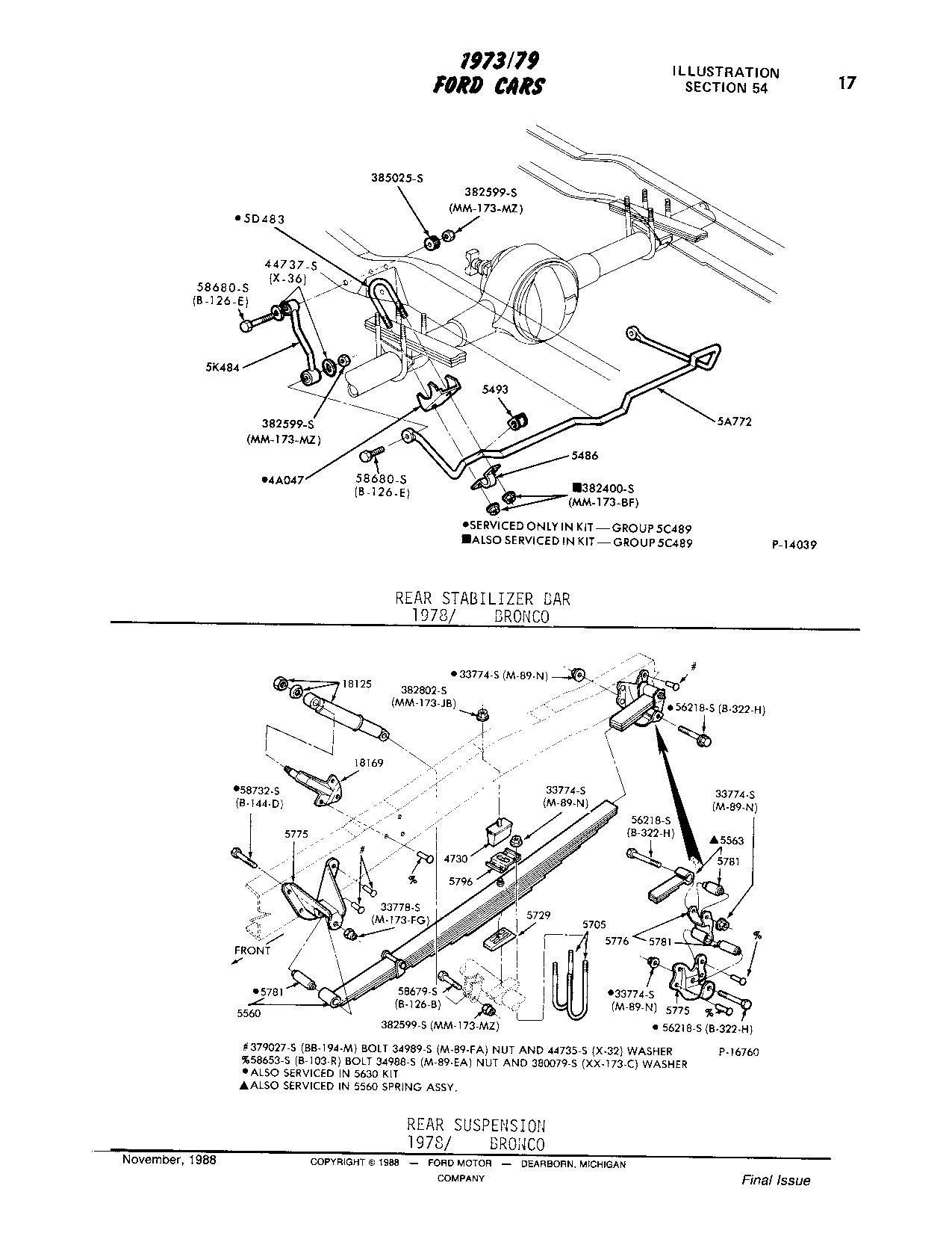

5K483.....Stabilizer Bar Link - 1975-79 Ford Truck D5TZ-5K483-A
https://www.ebay.com/itm/28364338630...hoCPNoQAvD_BwE
