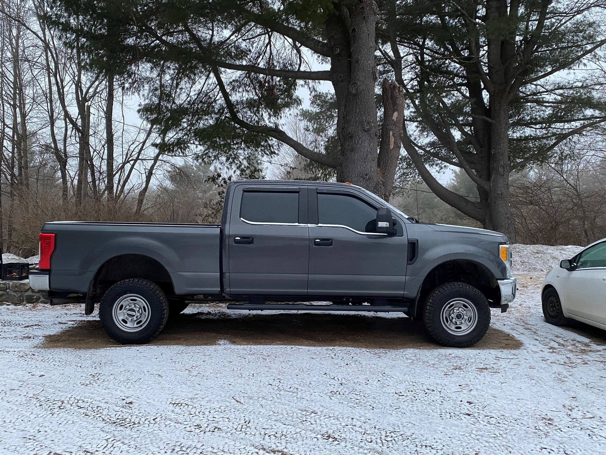

front level out
i took this the other day waiting for my haircut
she seems to be leaning in the front, a bit .
plus she bottoms out real easy on speed bumps at under 5 mph

Looks good to me, should be sitting around 2" higher in the rear. The earlier trucks like my 19 sit 3"+ higher in the rear.
There is very little up travel up front, I noticed that shortly after purchase. Take a look at the space between the bump stops and pad, not much space at all. Plenty of level options out there.

It does look low to me but there’s also different setups from the factory.
Yours looks like 6.7 no plow prep. My 6.2 with plow prep looks higher in front. But yeah as someone else said there’s not a lot of front suspension travel stock either way. You can change that as I’m planning on doing though if you buy the right stuff.
