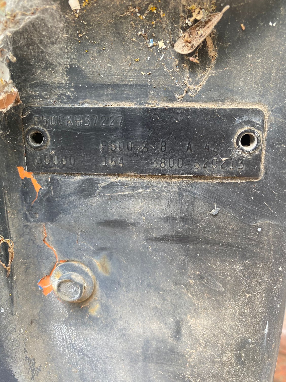

I did do some looking through the old decodes but couldn’t determine the year model definitely. Insurance documents in the cab say that it’s a 1967 but later documents say 1970 but they all list the same vin. I am guessing that it’s a late production 1967 since it has so many cab characteristics of the 1968. Best I can tell it’s a Kansas City build 15,000gvw with 164 hp @ 3800 rpms I just don’t understand how to date the H engine code number. I need to order exhaust manifold gaskets and a service manual so your assistance in determining a year model would be a considerable help and greatly appreciated!

Welcome to FTE! No need to apologize for a decode. Let's see if I can get it right.
F50 = F500
C = 330 2V MD FT gas V8. This is the engine that uses the cast 352/360 crank, small distributor drive and a couple other differences. Still an FT with the heads and manifolds, front cover and bell the same as the other versions.
K = Kansas City Assembly Plant
H37227 = 1970 series number
132 = 132 inch wheelbase.
No paint code. Note truck is a special order--paint could be part of it.
F500 = F500, 15,000lbs GVWR
4 8 = Standard cab. I do not have the upholstery info.
A = New Process 435 four speed transmission
42 = Timken model D100 Single Speed Rear Axle / 6.20-1 / 13,000 lbs. Rear Axle Capacity.
There should be a 3 digit after "42" for the front axle. Since it is missing, either your codes are "hung over" from the '64 to '69 practice of listing only optional axles, OR, more likely, your front axle was part of the "special order".
15000 = 15,000lbs GVWR
164 3800 = 164 Certified Net HP @ 3800 RPM
620213
62 = Houston District Code
0213 = Special Order Number
I'll be back, let me know if something doesn't match up.
F50 = F500
C = 330 2V MD FT gas V8. This is the engine that uses the cast 352 crank, small distributor drive and a couple other differences. Still an FT with the heads and manifolds, front cover and bell the same as the other versions.
Orange!
Jc Whitney? Or Ford?
42 = Rear axle code, I will be back to you on that.
620213
Thank you kindly for so much detailed information!
It has just been ingrained in me to do my own due diligence before asking for help!
I didnt want it to be a 1970, but it is what it is!
