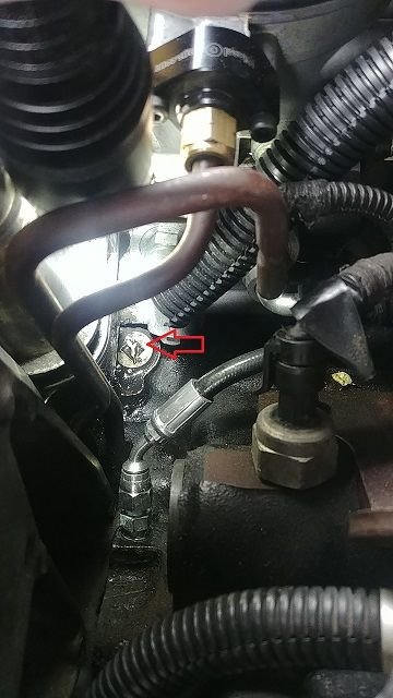

I have this weird puddle on this plug just under the non serviceable plug (first pic...red arrow)....but the non serviceable plug is dry as a bone. Fuel lines are all dry as a bone, oil lines are too.

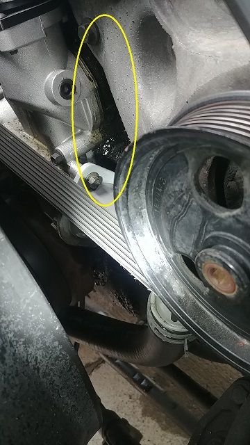

I had this leak before I started all this, and I thought it was the HPOP gasket. Old gasket looked good....new gasket went on. I cant figure out where this leak is coming from. I believe its oil....runs down the waterpump and blows back.

Red arrow shows that plug with fluid...could be clear oil from reservoir? Reservoir was filled with fresh oil before I started her back up.

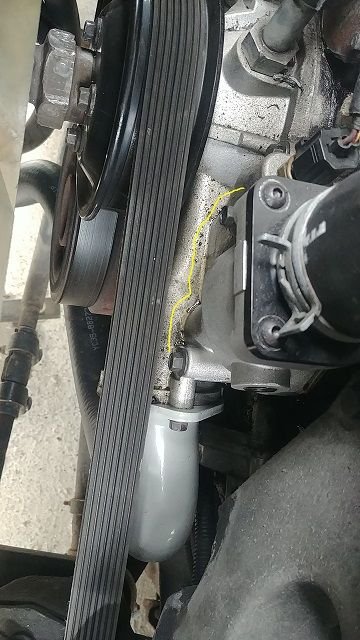

running down the water pump...I drew yellow line
behind the thermostat area

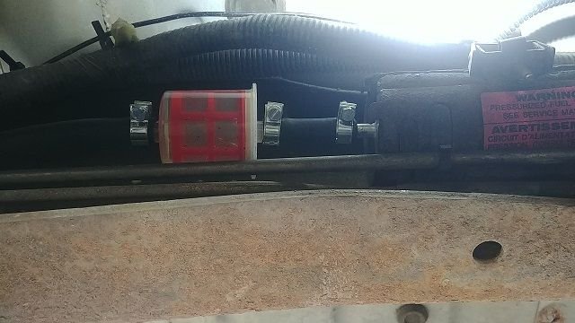

fuel lines are filthy...still running down, even on the lower hose....oil cooler is bone dry

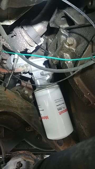

runs above oil cooler...you can see its bone dry here in the back too
Aaah....no leaks here...specks are on the outside of the filter too.

Hpop reservoir seal at the timing cover?

Nope that's the seal I was referring to. If not there then maybe the timing cove or that plug. You could try giving the timing cover bolts a little snug, might get lucky. The plug is the oil drain back passage for the hpo system, so I've read anyway.

I had to replace the o ring on the oil pressure relief valve/plug on my 01. I had no luck tightening it. You can get it out with 3/8 extension without removing the fuel bowl or hpop...it’s a total pain in *** though.
Ford o ring part # F4TZ-6674-A
