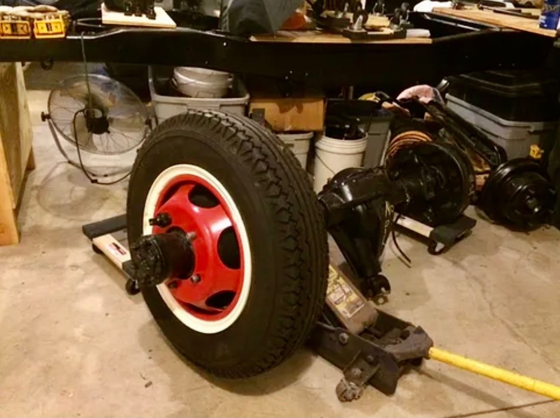

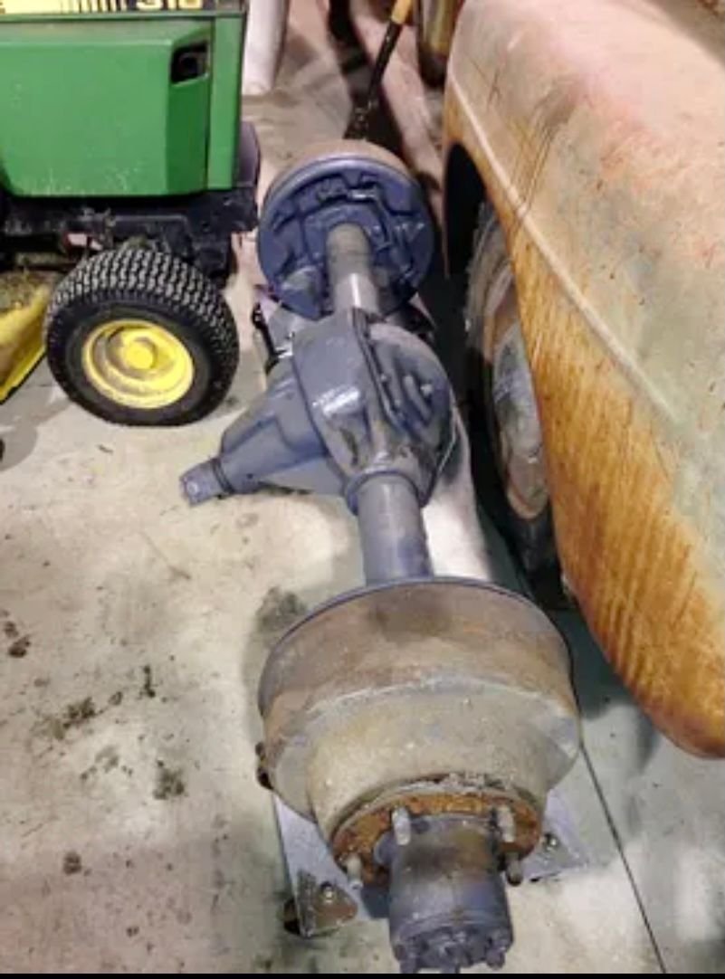

I sold one of these to a guy years ago that iirc had a 54 F-500. I should have kept track of him to see how it went. But lost his contact info. I heard from another guy with a Studebaker who was making the same swap. Below is a pic of the axle I sold, and the one the Studebaker guy was prepping for his truck. Stu
