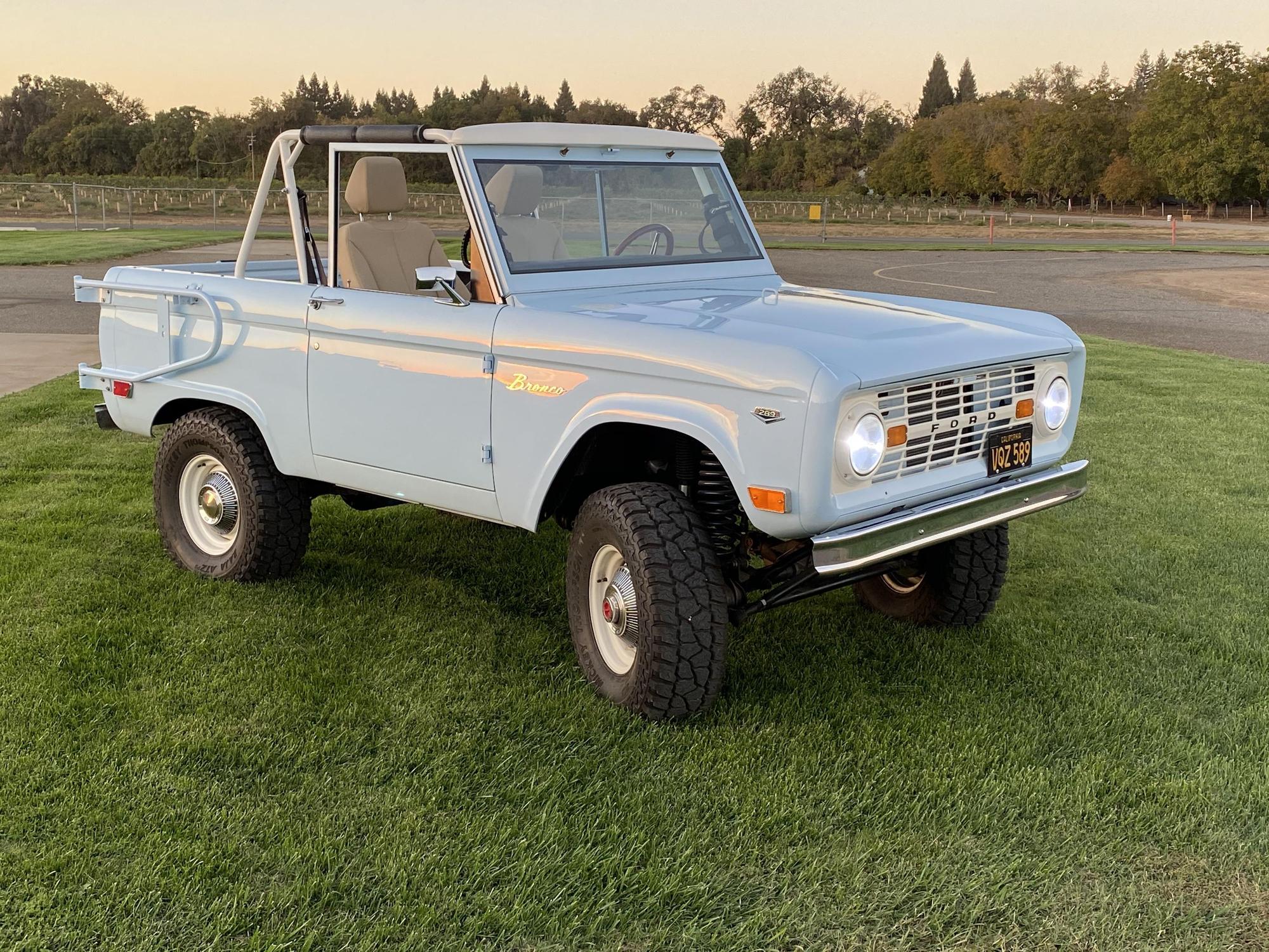

Those are ok, but I'm looking for a dog dish style.
Originally Posted by 68Flareside240
And to add to Rich's comment, if you go with any other wheel than the factory 5.5" wide, the hub will be inside of the wheel cover, not sticking through. Made that mistake after I found a set of the 73-79 mag style wheel covers with the hole up front for the hub, only to realize they mount too far out on the 15x8" steelies I bought to run 33x10.5" tires.
Thank for the input. I should have either 15 x 5.5 or 15 x 6 on my truck.
Found these on another site - they are mid-60's Galaxie hubcaps. Have to cut out the centers to use on the front.

Those look good. With a style that mounts on the center, wheel width won’t matter. I had to go 8” wide in order to run a tire of 33”. Really wanted to use the factory wheels but couldn’t find a tire tall enough for my liking, and narrow enough to satisfy the wheel.

Ok, that makes more sense.
FYI - you can indeed run a 10.5" tire on a 5.5" or 6" wheel. Not ideal, but can be done, as long as you mount yourself or find a shop willing to mount.

Yeah I know it could be done, a lot of the older toyota/samurai crowd does it. Read too many post about poor tire wear and ride characteristics and decided to be safe and comfortable. If I ever fully restore the truck I plan on putting a set of new repro bias plies and using them as show wheels with the caps. It was the only set of those hubcaps with the hole(looking back, I think the center FMC medallion can be popped out for hubs) and for $30 a piece in remarkably good condition I couldn’t pass them up. Wimbledon white steelies look good to me too through.
