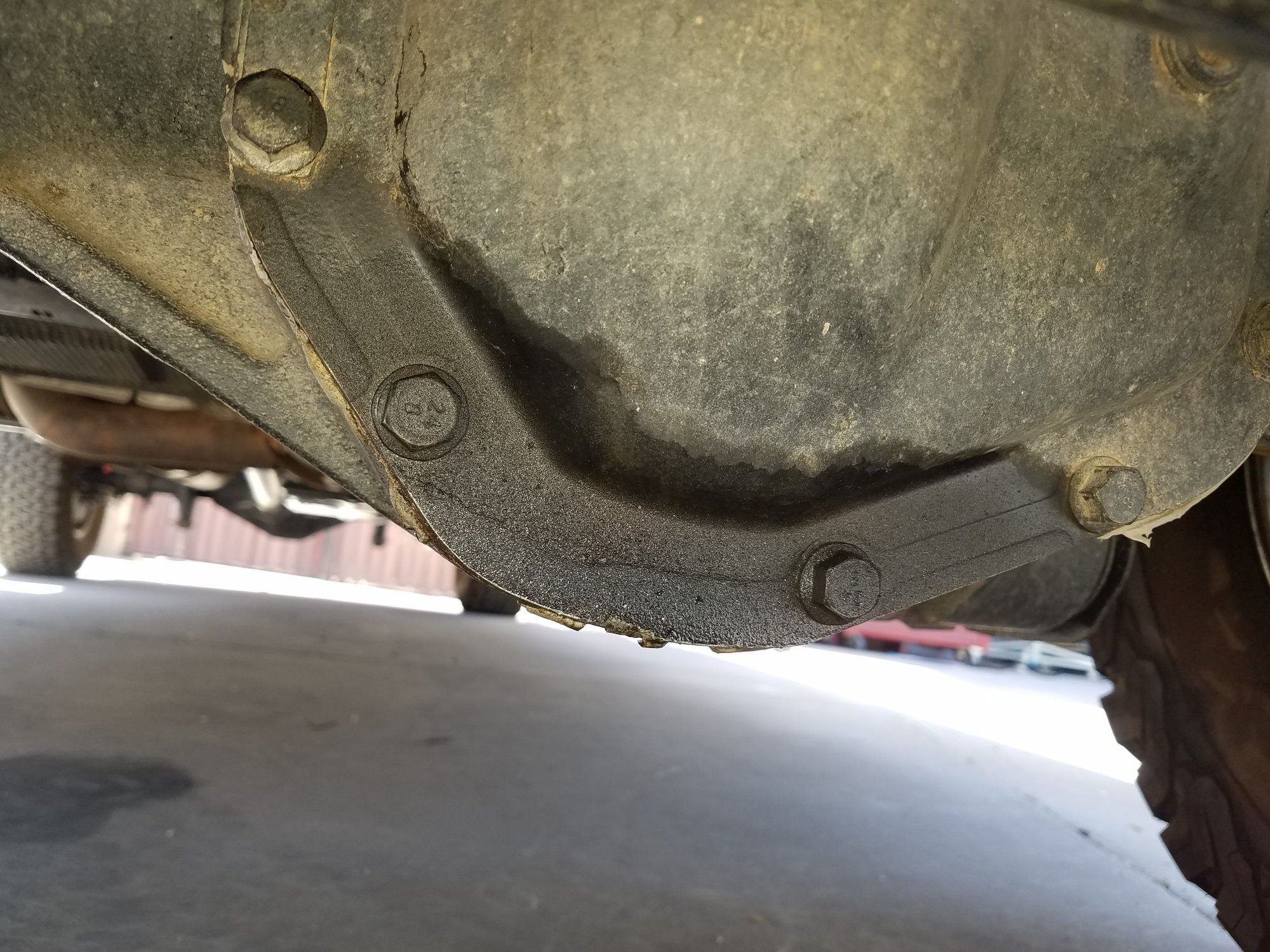

Anyone else having problems with their diff leaking? The truck is only one year old with 16K miles. Hopefully Ford will cover it under warranty when I take it to the dealer.

So what is leaking? Cover gasket? Try snugging the bolts just a tad. That will probably fix it. Or take it to the dealer and have bumbles the “mechanic” tear into it.

Don't be alarmed if they don't do anything about it. There's not even a drip on the bottom of the unit. And the way oil spreads, you're looking at about three drops of oil. They might fix it since it's such an easy repair, but they might say to come back when it's actually dripping.

I checked the level and it was good, and the bolts are snug. It just pisses me off.

Wash it off and see if, or how long before, it does it again.
May have just been residue from assembly.

Cleaning it and seeing if it comes back isn't a bad idea. If it does I would take it in for warranty repair. Nothing should be leaking or seeping at 16k, or even two three times that mileage. One concern I would have is if they try to turn it around on you, and question if you lifted the front with a jack under the diff.

no its not residue from assembly. snugging the bolts may work if it were a gasket but not with sealer. looks like you hit a rock or something as theres a gouge mark on the bottom. perhaps that disturbed the sealer just enough to create a small leak.
i would say just fix it yourself but nobody likes getting their hands greasy these days

I was going to ask if there might be just a small Arizona snake bite right on the bottom.

Put in a lube locker gasket and be done with it.

the bottom bolt is a drain plug..Im guessing it needs a little tightening..

Just buy a nice aftermarket cover

spray it off and see where its leaking. if the bottom bolt is a drain plug mayge its the source. could put some sealer on the bolt shoulder

this. The time spent driving to the dealer, waiting and driving back home will take you longer than just doing it yourself. Would be a good reason to change the oil (but then again I'm one to avoid dealers at all costs)

It looks like a hairline cracked between the bottom two bolts of the cover when you zoom in.
