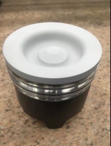

It’s not that uncommon for these pistons to crack. It’s hard to say if your crack was causing a loss of compression. The cracks generally originate in the ‘lip’ on the edge of the piston bowl. It is common practice to mill the pistons and remove that lip. The higher HP engines I’ve gotten to build also got ceramic coated piston tops and Teflon coated skirts.
Mission creep is REAL and it’s hard to do a really good rebuild on a budget. By the easy math, you’ll be about $1200 into a Ford master rebuild kit with new pistons and ALL of the regular engine parts you’ll need. Expect $500-800 at the machine shop depending on what the heads need (valves, etc). I like to port and polish the heads and use a Stage 1 cam. Then at least 910 valve springs and chromoly push rods. Maybe have some stock forged rods cryo’ed or step up to some Carillo or similar rods if you’re a high roller. You’ll still want a fresh HPOP and injectors and of course a new water pump and sensors are always nice. Little things like a weld in dipstick tube, pro bed liner on the oil pan, paint, powder coat, ceramic coatings etc add up fast!!
Really no reason for compound turbos, but is easy to spend another $2-3k on a T4 system and a Borg Warner SXE turbo to match your new Bitterroot Diesel injectors........
I sell good, used engines for $2000-2500 when I have them. Over the years, I’ve installed a bunch of these for people and never had a catastrophic failure. (Knock on wood!!!)
The only place I would buy a rebuilt 7.3 long block from is Asheville Engines.
Good luck and keep us posted.

Those photos are 7.3 p0rn!

SkySkiJason thank you that is some very good information. And that is a great looking engine. I only hope mine will look that good when I am done. I am not in a hurry to get this done as it's not my daily driver. It's a project that in the end I would like to hand down to one of my boys who will hopefully treat it the way it should be treated. Thanks again.
