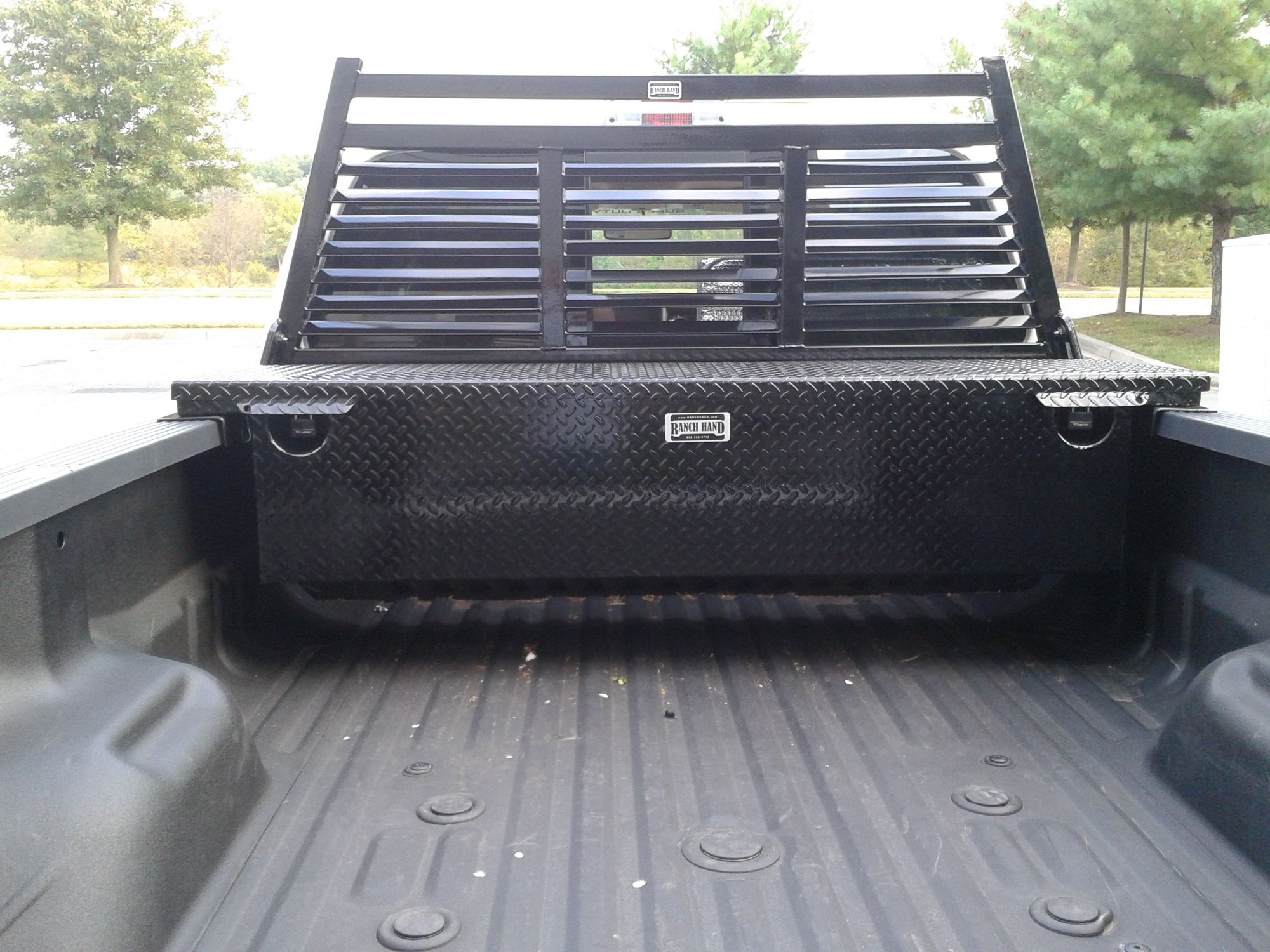

Old May 12, 2021 | 05:23 AM
senix's Avatar
senix
Joined: Aug 2008
Posts: 37,384
Likes: 1,868
From: Frederick, MD
get it. Goes without question.
this is what the bed will look like. You can see where you lift the covers and drop the ball in or attach the hitch through the holes

Old May 12, 2021 | 07:25 AM
dugals's Avatar
dugals
Joined: Apr 2021
Posts: 97
From: Canyon Lake
Thanks to all for the insight and thanks to Senix for the pic. Going to contact my dealer and see if it can be added.
