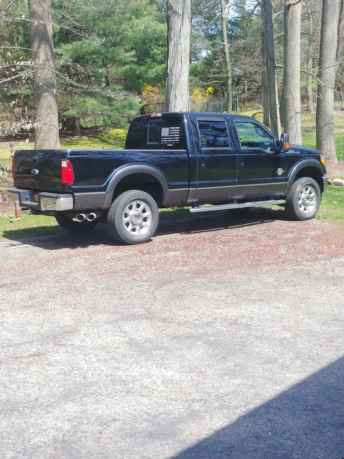

If it doesn't have the factory front end rake, then it must be leveled at the minimum. Here's a pic of my stock F350.
