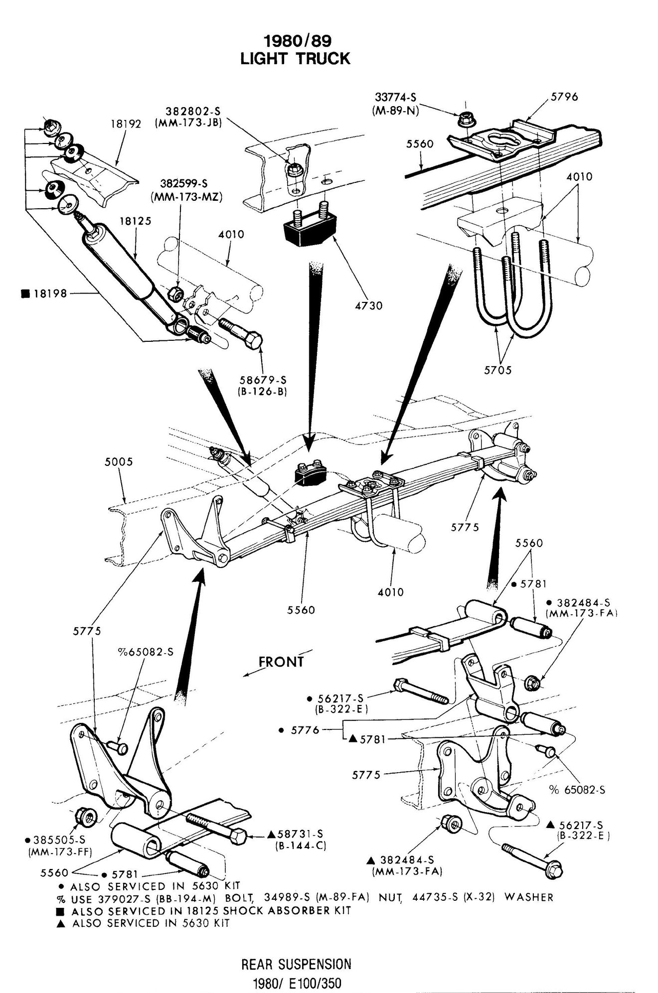

My 90 E150, has the left rear shackle just about rusted away. Is there a place That sells a decent built one? Most of the stuff I'm seeing looks like its only about an 1/8" thick and by the looks of the OEM, I'd say those are at least 3/16th - 1/4". Thanks for any info.

This is what I'm looking for, D5UZ-5775-D or D5UZ5775C They're discontinued Obviously. I haven't measured the wheelbase yet so I'm not certain which one I need. What you guys are suggesting are the Shackles, which I guess I did say shackle, I guess I meant to say the perch, the actual part thats bolted to the frame. Sorry for the confusion.

this one?

Yes very similar, I'm not sure if mine has 4 bolt or 6 bolts. I'll have to climb under it again...I do know that the bracket has rusted away completely around one of the top bolts.

sdtrucksprings lists one for the 1990. Requires their shackle I think.

Here is some more info.. I am looking for the part number.. ,one is the front and one is the rear
