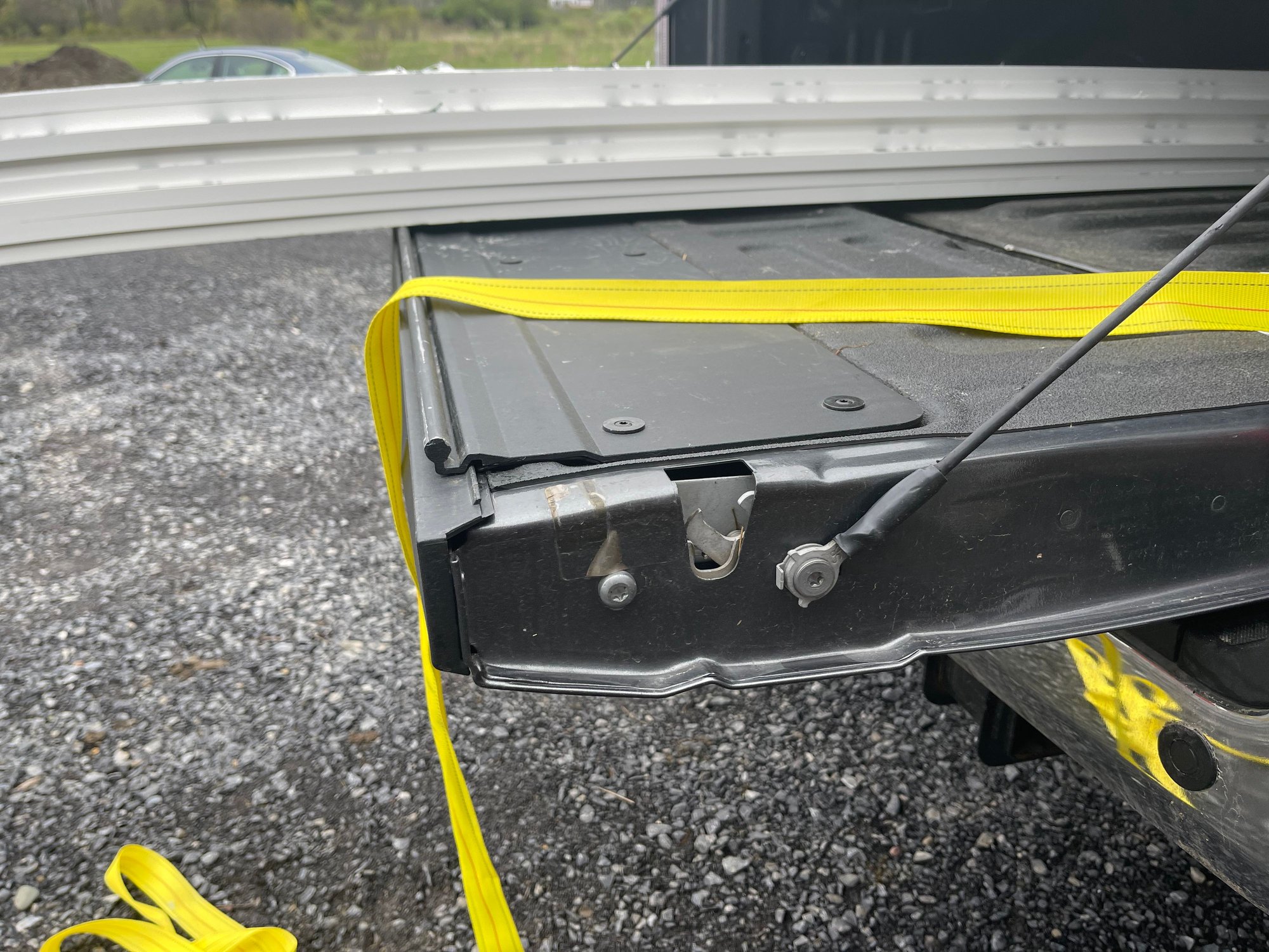

They will interfere with a cover, particularly a hard cover. With my Bak X4, with the ramps in the brackets, they sit too high in the bracket to allow the cover to roll closed and sit properly in the rails. Also, the rail on the metal plate that is mounted on the tailgate will hit the latches of the cover, and also the weather-stripping along the back end of the cover. I trimmed 2-3" off each corner of the plate to clear the latches (I wouldn't need the ramps to be that far out anyway), and pulled the weatherstripping off the cover (I may try to replace it with a thinner piece at some point, but I'm not overly concerned with the cover being 100% water-tight. If I need to use the ramps to carry a motorcycle, I can mount them in brackets and just leave the cover open, but I don't need them that often so mostly they're just stored in the garage.

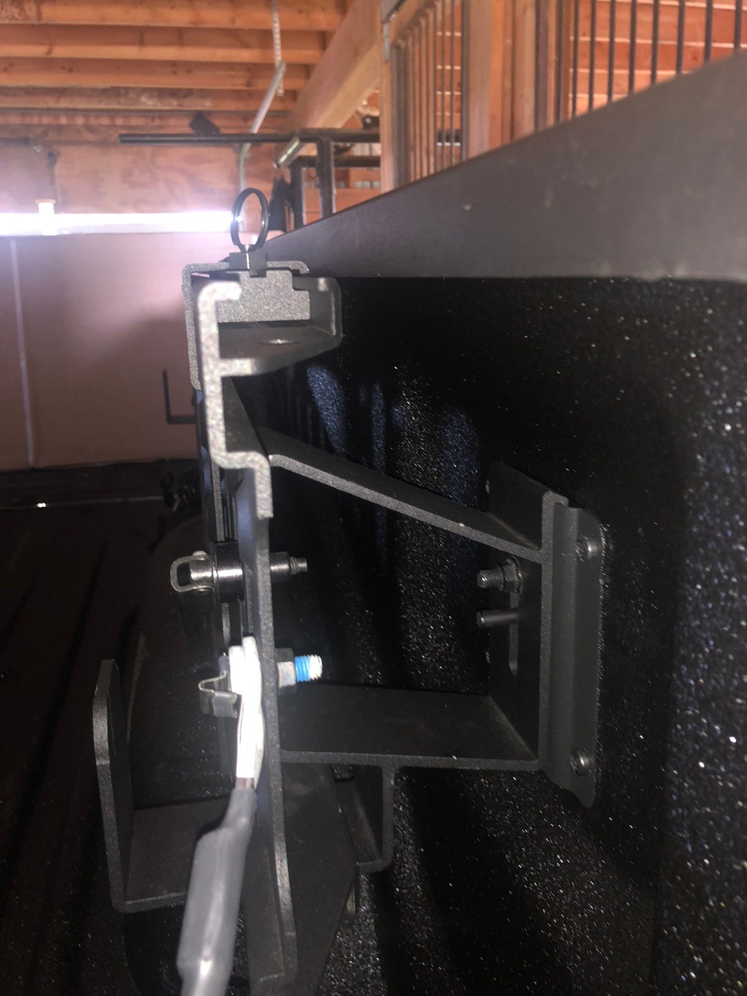

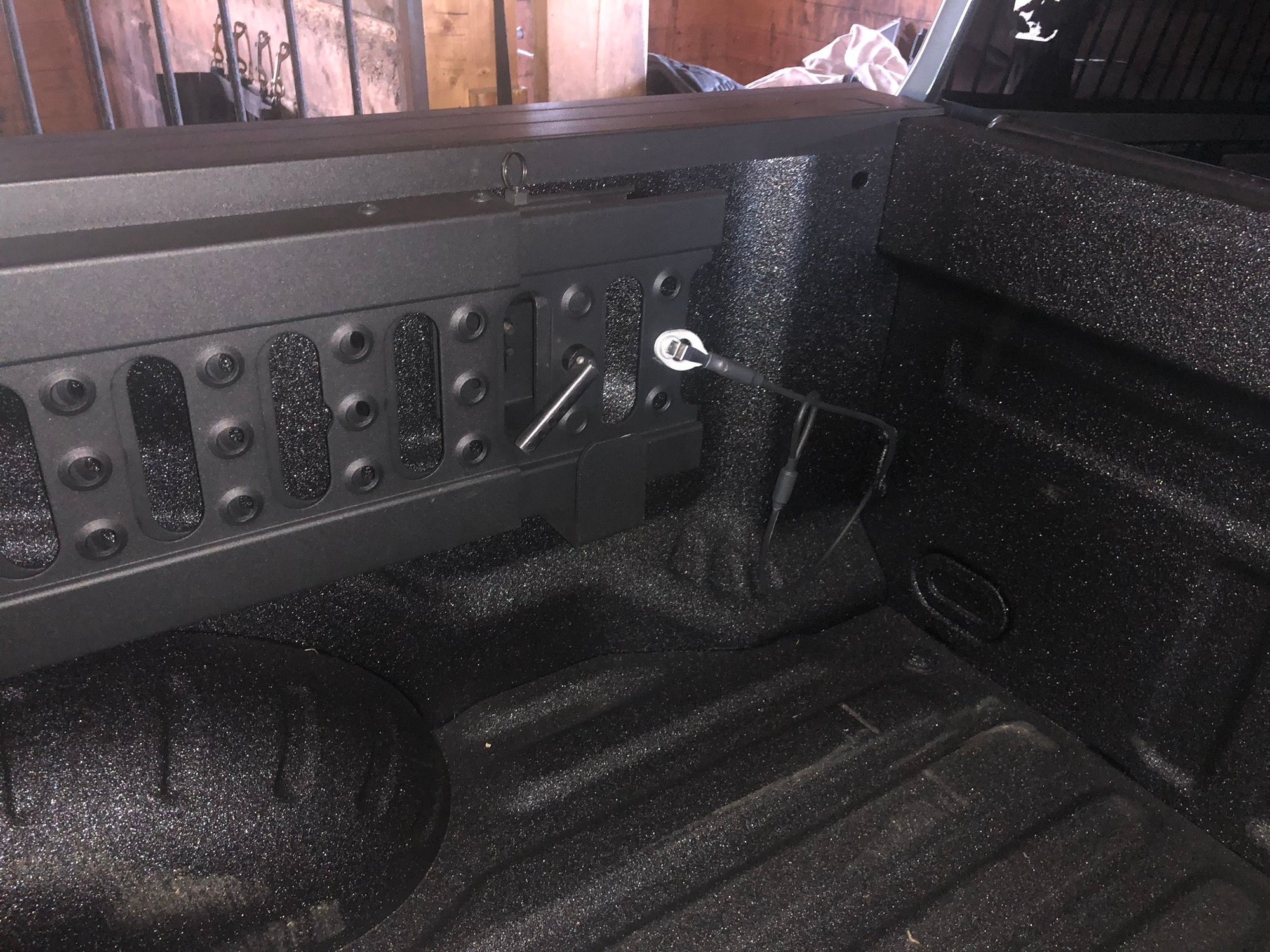

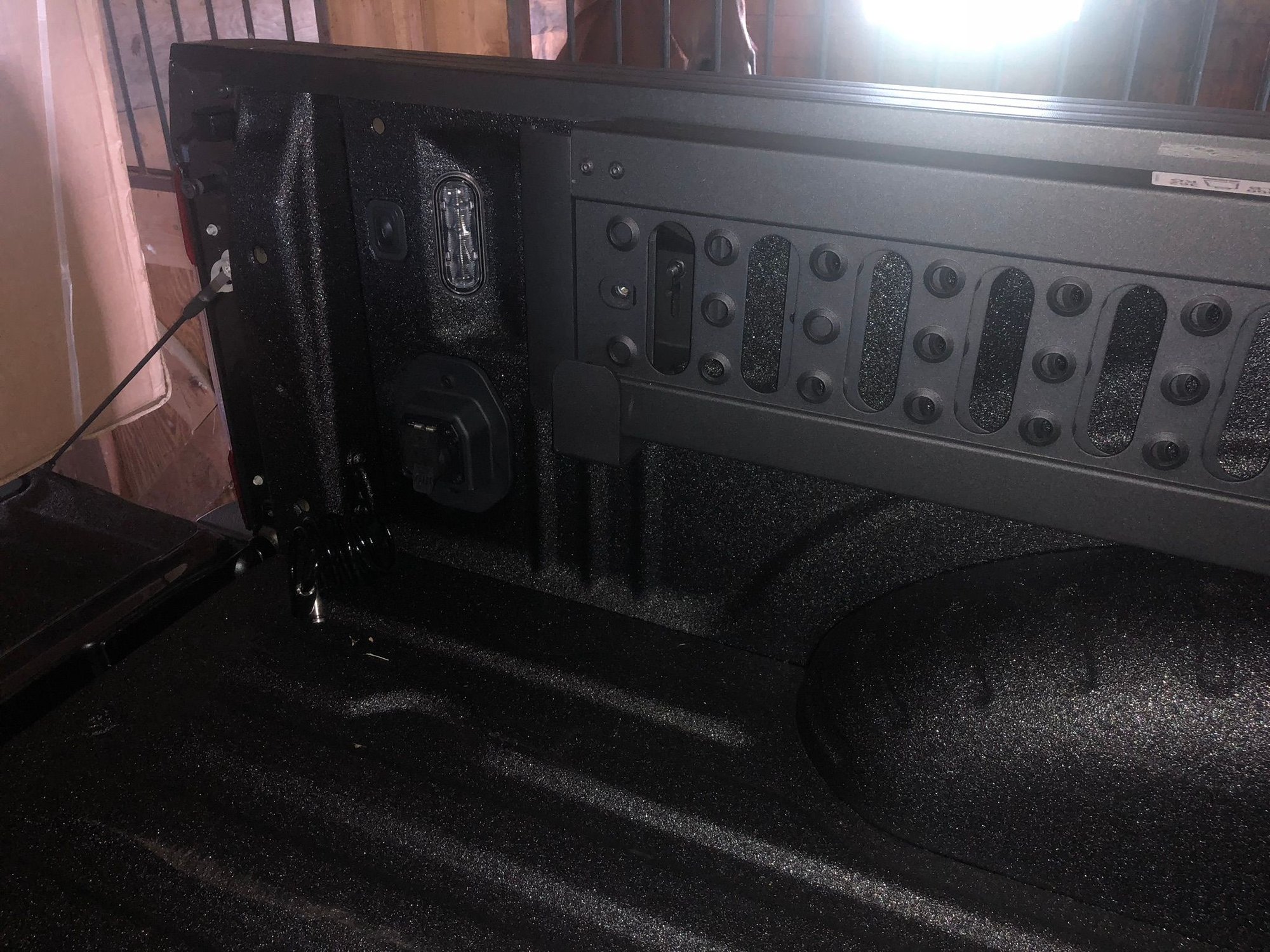

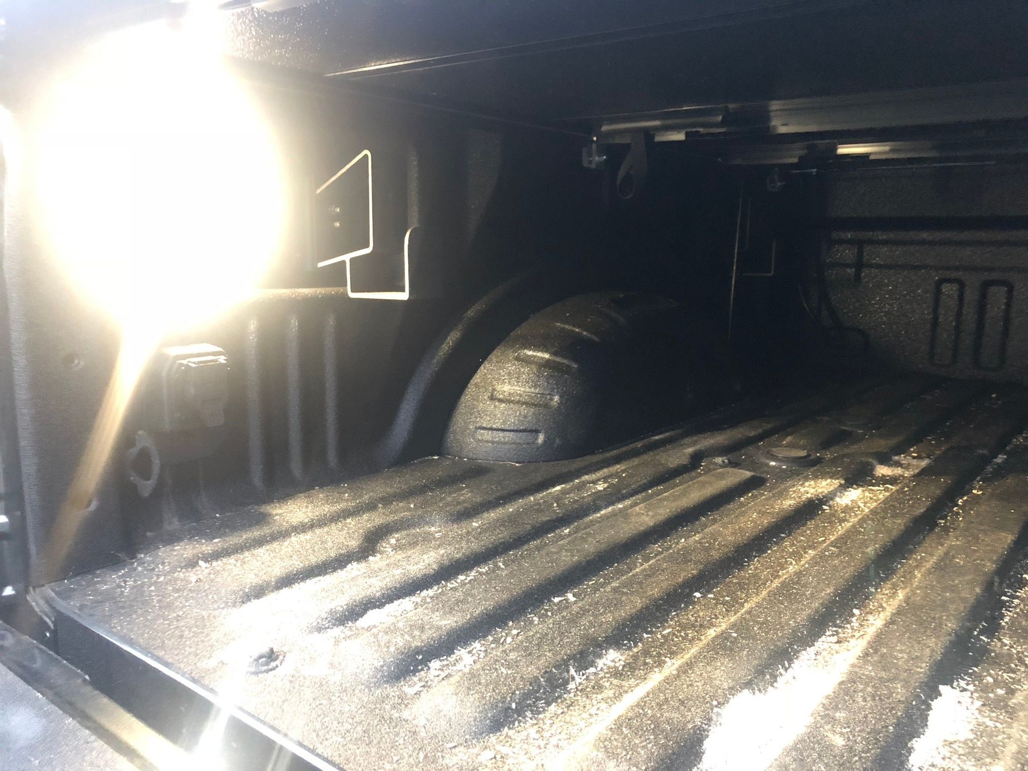

They do interfere with a below bed rail mount tonneau but not an on rail mount tonneau. I always intended to lower the bracket to cure the interference with my bakflip but never got around to it. The mounting brackets don’t interfere, so in practice I leave my ramps hung up in the garage when not in use and when I’m going to use them the tonneau cover gets folded up anyway so the interference doesn’t matter.
They are as safe as it gets. Glad I got them.

@Section179 Assume that's the factory spray in bed liner? Always gone after market due to seeing such low quality from factory sprayed on liners in the past. QC and/or application techniques must have improved.

i think it’s excellent. It’s not a grippy as linex but I find I actually prefer it being smoother for sliding things in and out. More reminiscent of a plastic liner.
the thickness and lines on install are excellent IMO.
one last note- the bracket for the ramps is an awesome tailgate lip protector. Been pleased with that.
