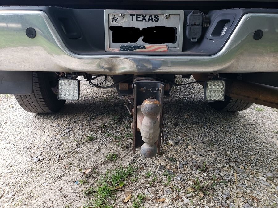

This is what I mounted on my hitch! They're cheap LED lights, but they work!

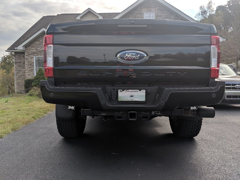

I used these Alpena Dual Pattern LED Lights because they have a spot and flood pattern in each light. Because I am OCD I disassembled one of the lights and flipped the optics so that both floods are to the outside. They are cast aluminum, the cover is held by 4 screws and has an O-ring to seal it and the polycarbonate lens will likely live long since it isn't facing forward into the dirt blast coming of the roadways. I've pressure washed them and have had no issue with water intrusion. They come with stainless steel mounting hardware. I drilled the bracket out a small amount and used an existing body bolt to mount them. Wired them into the backup light circuit with a relay so they only activate if the lights are on. On my F-150 I used a larger, brighter set and they were actually too bright for the camera so I decided to give these a try. Very happy with them so far.

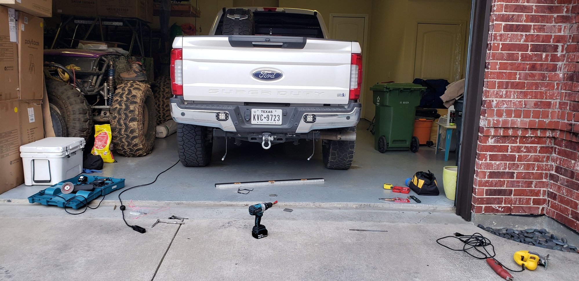

I love these flush mount installs! not sure i have the courage to cut into my bumper. how are you guys cutting these in? do 1/4" hole in each corner, then use a metal jig saw?
Old May 9, 2021 | 10:07 AM
philips's Avatar
philips
Joined: Dec 2003
Posts: 488
Likes: 142
From: Indianapolis

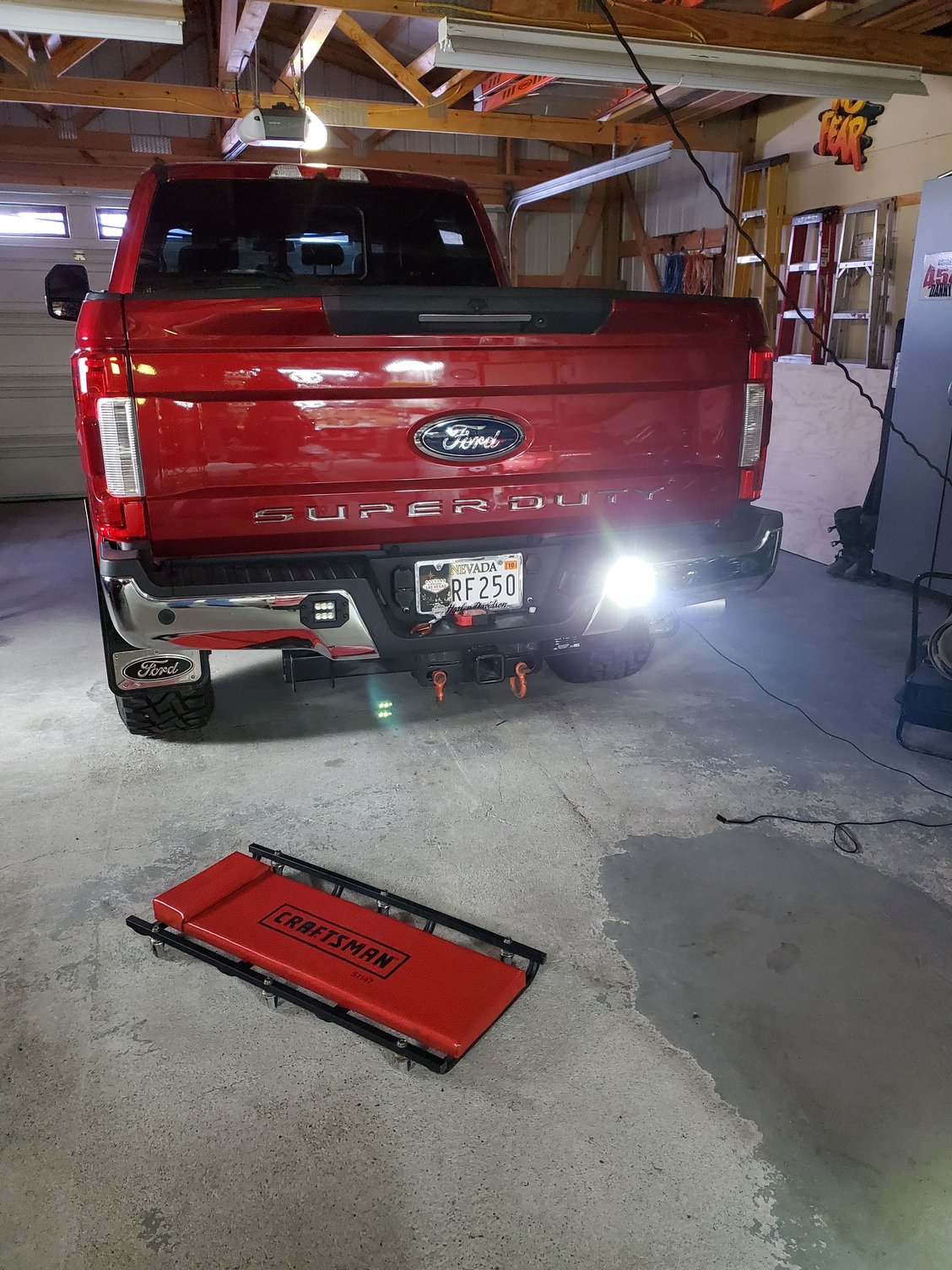

Cut out opening for these this morning, paint is drying on cut area now, so will actually install next week. I already have wire run from #1 aux switch, grounds made up, just need to mount relay and pull reverse power from in bed 5th well connector under truck. I used gasket to draw outline, drilled corners, used cut off wheel to cut out, touched up as necessary with die grinder. Philip.
