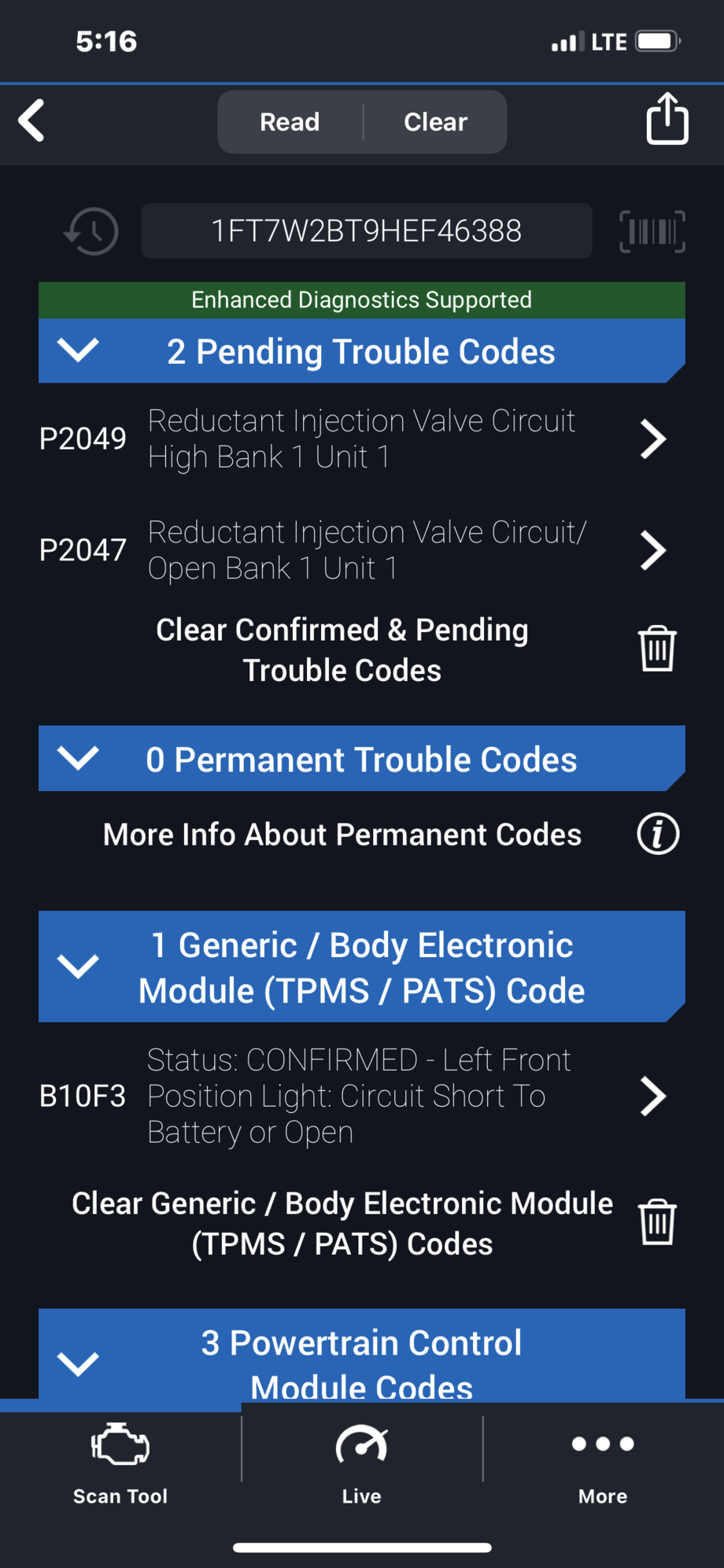

Ok so on the way to work I didn’t get any faults . Now on my way home I got a check engine light. Ran my reader and this is what it was . So this whole time I was thinking it was a dpf issue and it’s a def injector issue . I thought it injected def to regen. I have an injector on order.

The pcm codes were the P2049 two times and a P2047 both the injector
