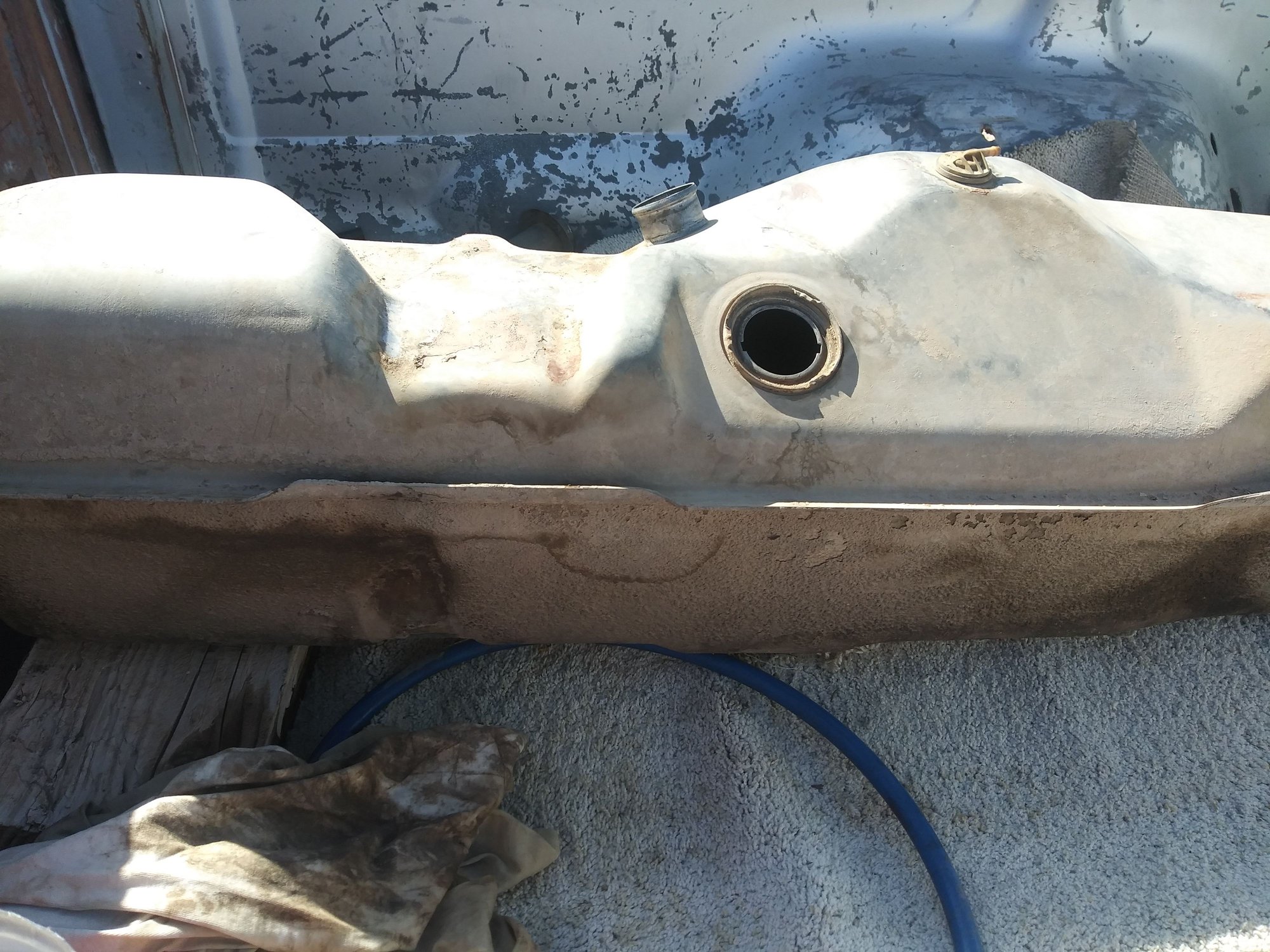

I assume this is an F350 ad IIRC not all of them had ELEC pumps. Do you have a shot of the top of the tank.

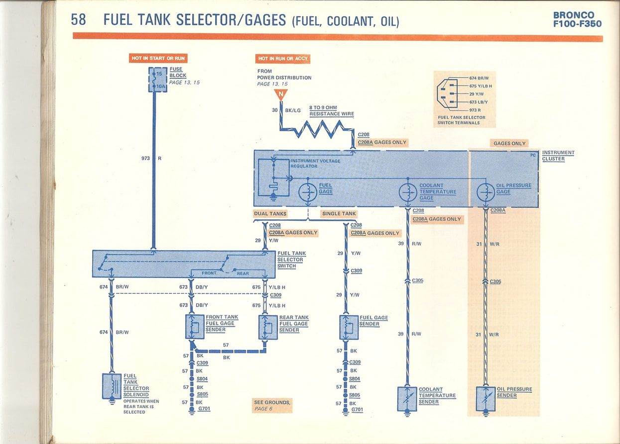

The diagram below is the only one in the electrical manual for the 1981 series trucks with dual tanks. Ford makes mistakes all the time in the their manuals and literature, but the diagram below shows no electric fuel pumps, and you do not have electric fuel pumps. If you only have two wires going to your sending units, then it's a safe bet your truck never had electric fuel pumps, you would need another wire to each sending unit to power them.

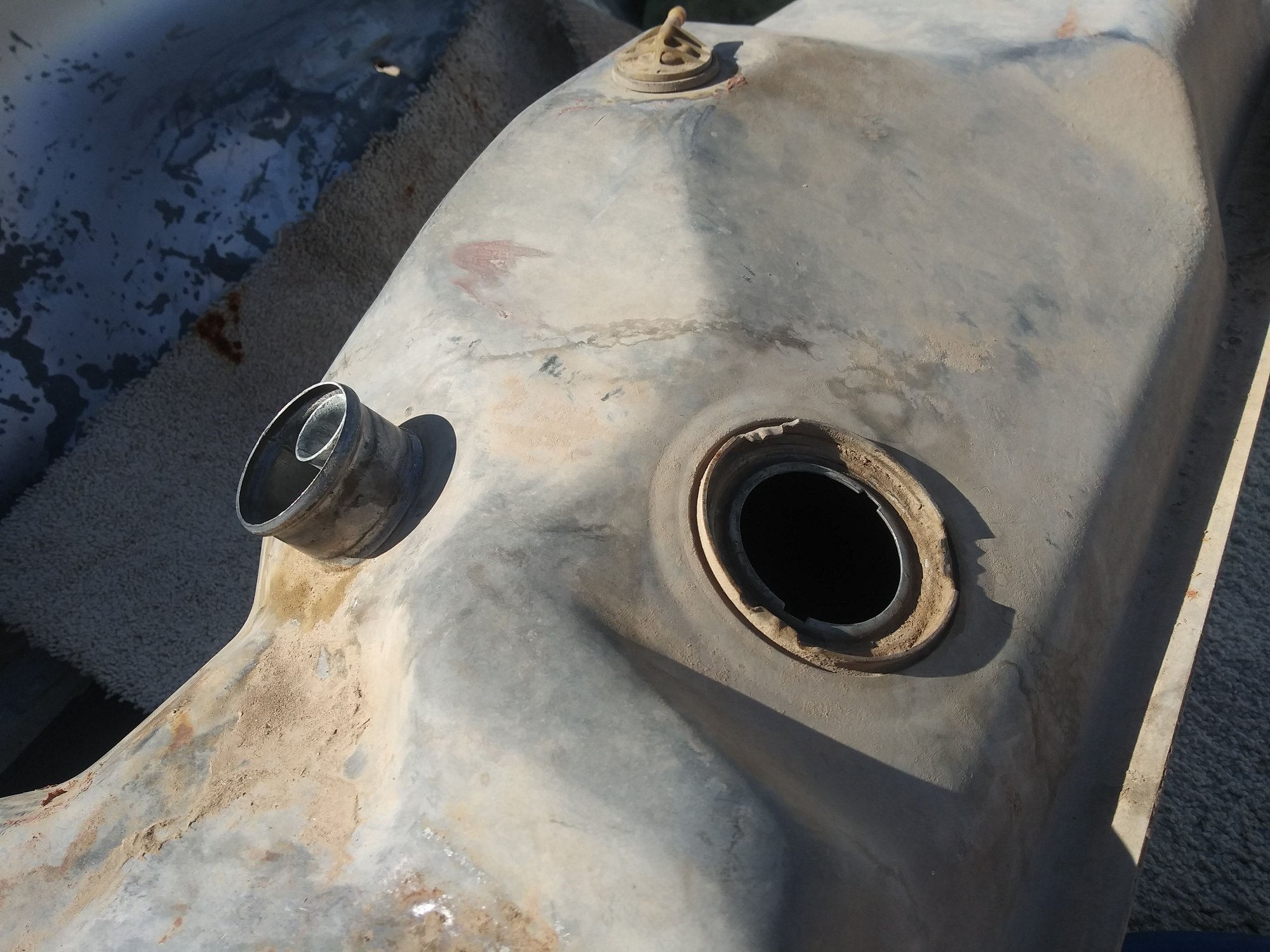

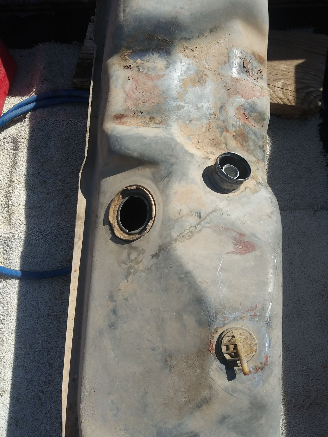

Originally Posted by matthewq4b
Electric in-tank fuel pumps WERE fitted to some 400 applications. The tanks were unique to that application hence why I asked to see the top of the tank. Cause I cannot recall if all F350 applications had them or not.
Sorry for the delay, here the pictures.

Mechanical pump, your truck never had an elec pump. So run what ya have.

If they did have electric in tank pumps, it would be some oddball early setup or it would have had a oddball fuel tank. When they went to in tank pumps on the 460's, they changed all the tanks to the large sending unit hole style so the pump style sending unit would fit into the tank.
I believe you, but it would not have been something very commonly produced. I suppose if you order enough trucks, Ford would build you anything you wanted.
