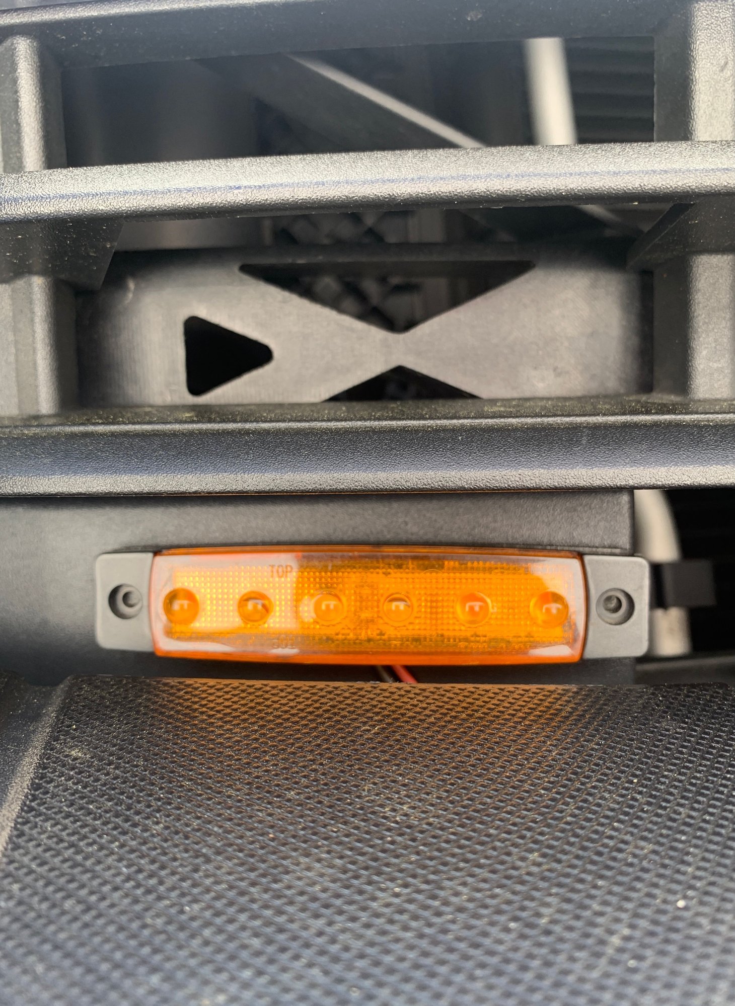

Just wanted to use my up-fitter switches, seemed like an easy install. I ended up drawing up and 3d printing some stick on brackets for attaching the lights with some 3m tape. No holes to drill, but did have to cut out that center fin in the grill to get the center light, well, centered.
3d printed bracket
Light and 3m tape added
installed

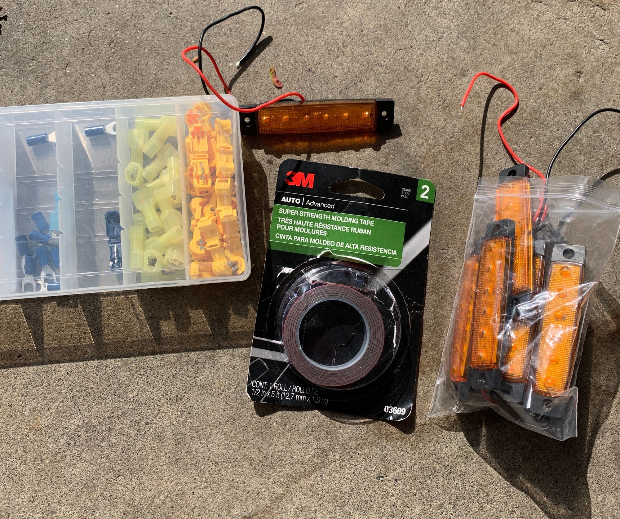

I wired them all to an upfitter switch and just leave the switch on, so they come on when I turn the key. I found flat spots within the grill and the bottom air dam and taped the thin LED lights on with double sided 3M tape used for auto molding. I also positioned them so they were somewhat inconspicuous during the day. Everything came from Amazon. The lights are really cheep and I've had them on for over two years and work perfect. Search amazon for " 3.8" 6 LED Amber Side Led Marker" a bunch of different companies sell them.
