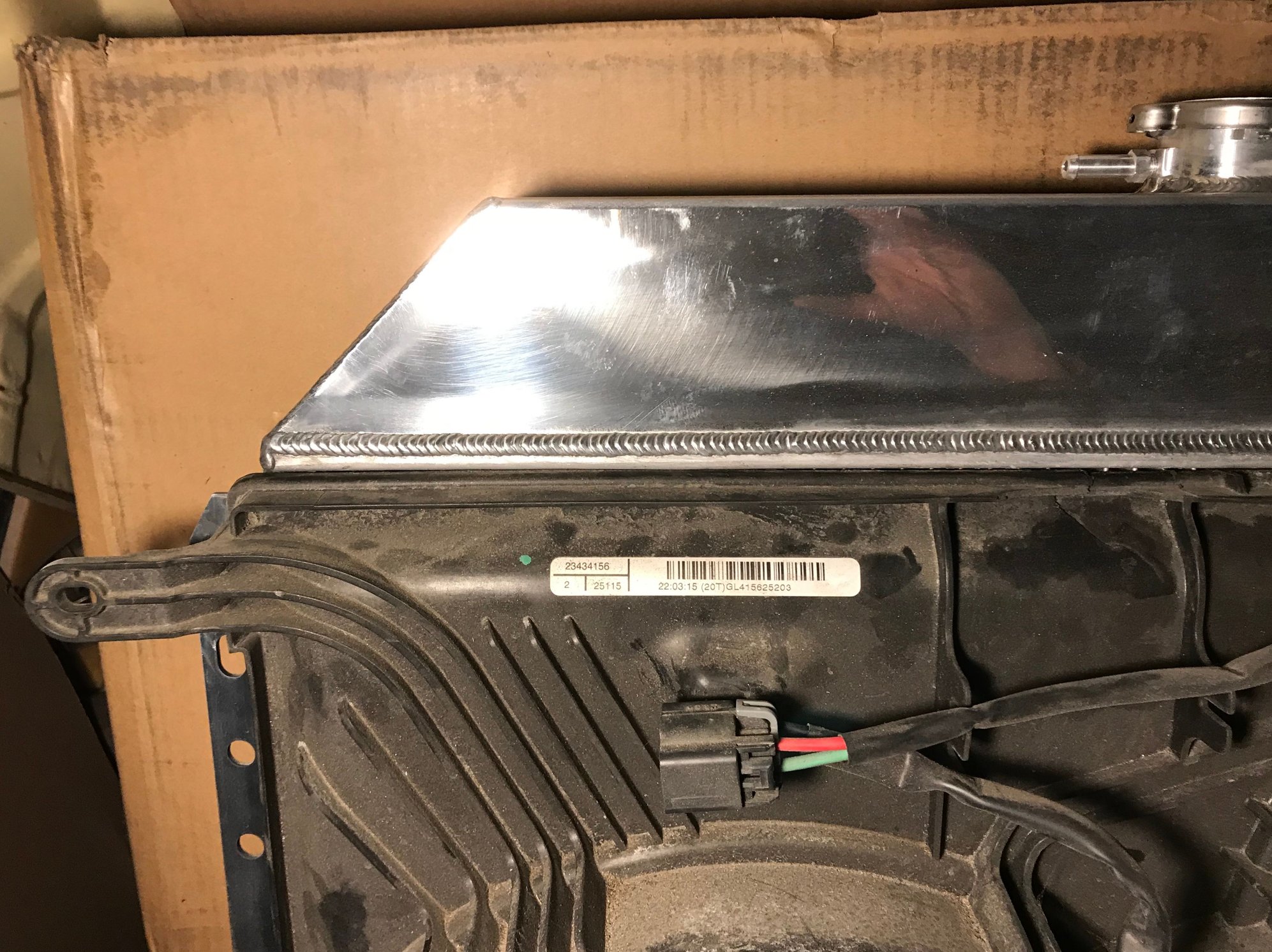

I use a OEM fan assembly from a Chevy Traverse. It has two fans, one 40 amp, one 30 amp. It fits the core of our radiators perfectly, covers all the core. I have one on each of my dentsides. Mine are controlled by Fitech computers.
I have used the Volvo BMW controller route, it does work well.
Jess

Hey there, Jess.
I don't know much about that fan system. What year Traverse? Can you share some info? So it's a dual fan? And when you say one fan is 40 amp, and one is 30 amp, what are you referring to? Surely you can't mean that they draw 40 and 30 amps when running? The most powerful fan that I know of, the Lincoln mk V111, only draws about 27 amps on low, and that thing will suck a cat to the grill, ha ha. Are the fans single speed? Low turning on one fan; high operating both? I'd love to see a photo. Thanks.
Is this what you have? https://www.1aauto.com/chevrolet-gmc...IaApi_EALw_wcB
That looks very much like the Ford Contour/Mystique fan system I use. What is the size of the fans, from fin tip to fin tip, or diameter?

Can't remember the year of the fans, late 2000's early 2010's? Primary fan had a 40A fuse and the secondary fan had a 30A fuse in the vehicle I pulled them from. I just went with that. Fans are single speed, I have the 40 one come on first then the second one if the temp goes higher. All done in my Fitech. I'l try to find a picture of it on my computer.
Jess
Old May 25, 2021 | 08:37 PM
RalphXL's Avatar
RalphXL
Posts: 365
Likes: 13
Here's a couple of the fan sitting on top of my radiator. I don't have any installed pictures.
Jess
