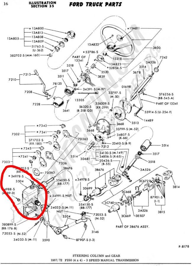

Hey folks,
Can someone help me identify the steering box that is shown in the diagram below? I have a 67 F250 M/T 4wd. I've looked through the Fordification site and it doesn't seem to be the steering box that was "supposed" to be on my truck. I can't find anything in the service manual that matches what's in my truck. The box in the drawing is the closest one I've seen. I have 2 issues, what lubrication does it take (I'm sure its oil instead of grease) and I need to replace the seal behind the pitman arm. I'm looking for some references for this steering box. Thanks in advance.
