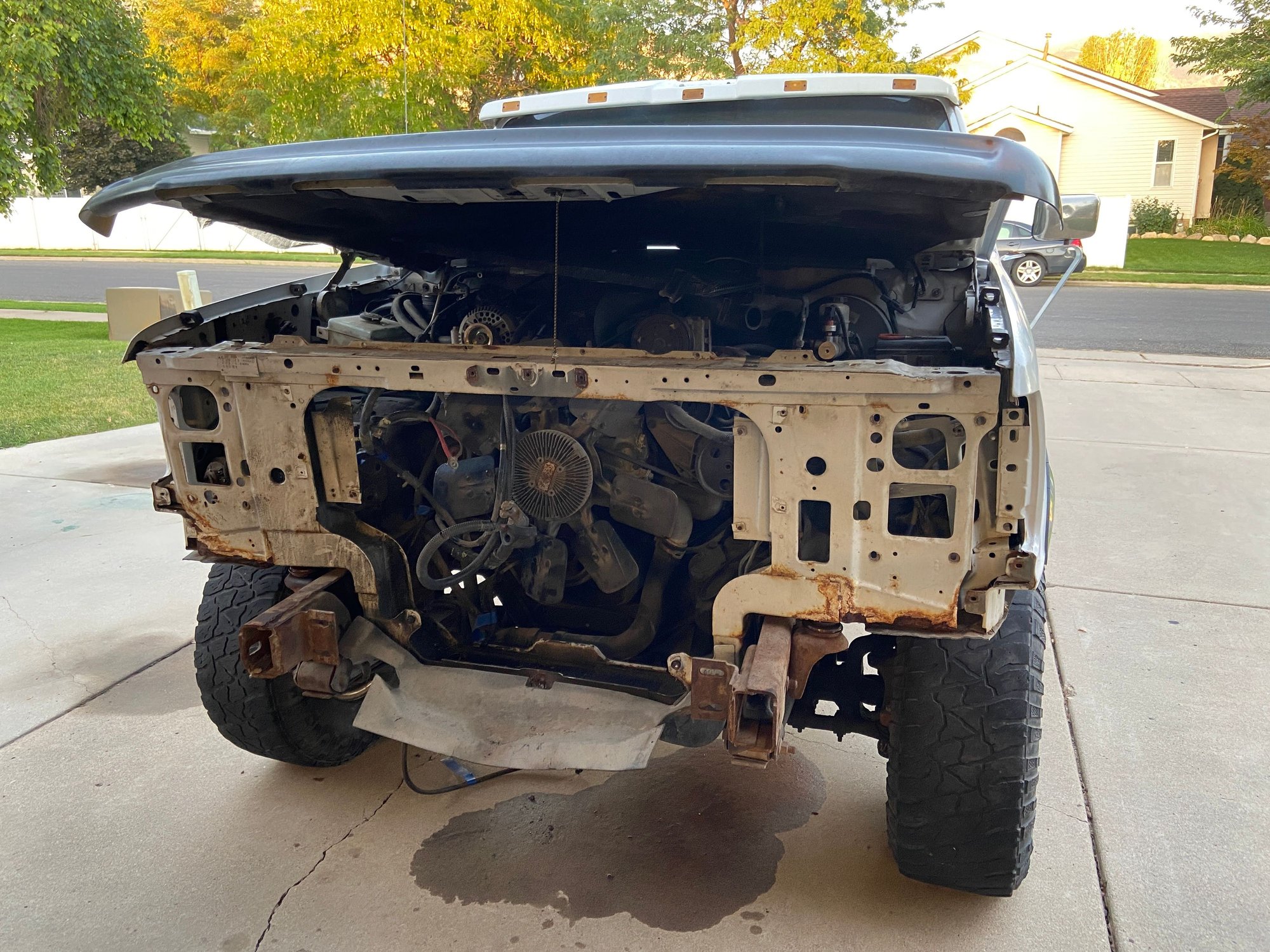

This has probably been asked but I couldn’t find it in the posts. I have been slowly getting my truck taken apart so I can pull the engine to change the oil pan gasket among other things. Since the engine will be out could someone give me a list of things that i should probably just take care of at that time before putting back in the truck? For example should i go ahead and change the rear main seal etc. etc. etc. even though it may not be needed. Truck has about 170,000 on it and has not run for about 5 years. Currently my plan is to replace both fuel tanks, change over to electronic fuel system, pull the injectors, replace the injector cups and reseal injectors, replace the glow plugs. Not that I want to just throw new parts at it but I also dont want to pull the engine again in another 50,000 miles for something i could have done now. Any help or suggestions is much appreciated. Thanks.

EdgeThis, thank you for the input. Since the truck has not run for 5 years would you also recommend i should pull the heads?

The reason it hasn’t run is because it lost power. Wouldn’t go over 30mph with the pedal floored. My investigation showed a fuel leak in the valley as well as multiple oil leaks around the turbo pedestal. The turbo actually looks pretty good (not dusted as far as i can tell) but i believe there were issues with the UVC harness also. The oil pan gasket was leaking also. Bottom line is I decided to yank it and rebuild what i could while it’s out. I have about $3,000-4,000 i can put into this rebuild. That’s why i am asking what else i should look at. Not really looking for a street racer pickup, just a reliable one with maybe a tuner for extra HP when hauling. So any other suggestions you have are great. Thanks

One other item of note is I think the EBPV was sticking.

I agree this is a great option. Based on the money i have and every ones input I believe I am going to do the following:
- pull engine, get heads off and take a look everything (if it looks good)
- reseal everything (CP addict has a Mahle reseal kit for $262.) Thoughts/suggestions??
- new injector cups
- clean and reseal injectors
- new glow plugs
- new LPOP
- new gas tanks (mine are rusted)
- Go with the superduty e-fuel system mentioned
At that point the engine should be good. However the work wont be done. I also plan to pull the bed and clean all the rust off the frame and repaint it. Same thing in the engine bay. I dont have a way to pull the cab. New brake lines and brake pads.
At the moment I also have the Radiator support out due to rust
