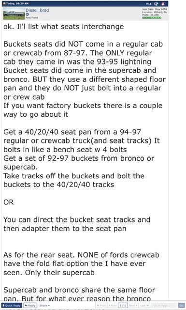

You can get a set of captains chairs from a bronco or super cab, and bolt them to a seat pan (from a 40/20/40) from a regular or crew cab, and bolt the whole assembly into your truck. These seat pans fetch a decent price.
