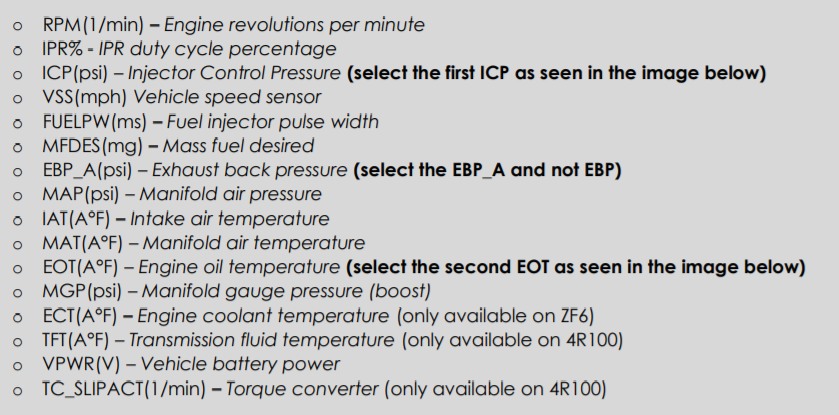

Mike, some FORScan logs would certainly help us help you.
Some key PID's you will want to log data for are below:
Also, please ensure your units of measurement are set correctly for PSI, Fahrenheit, etc... We can translate them later if needed, but it is sooooooo much easier if they are set correctly from the get go.
I am not sure how adept you are with FORScan, so here is a link to a Q&A created by FTE'r BWST a while back.
https://www.ford-trucks.com/forums/1...d-q-and-a.html
Keep us updated!

That's the list I set up on my tablet, just needing to coordinate logging time.
