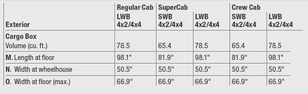

Excerpted from their respective sales brochures ...
2009 F-150
2017 SuperDuty

A little wider & longer, but less CF.
I wonder, are the frames wider as well on the Super Duty? If the mounting holes are the same, I think I'd go for it.
I think I will have to go measure things.
