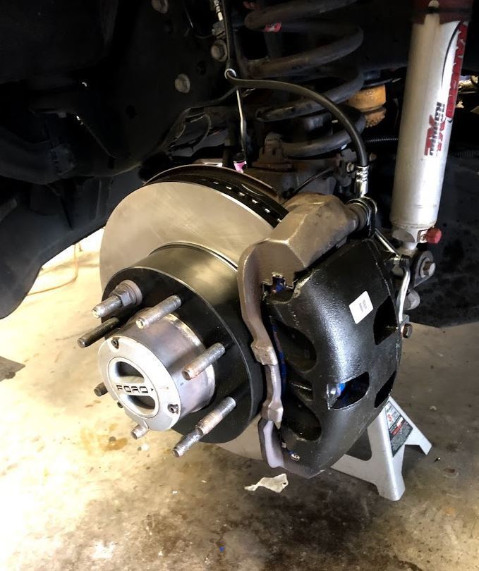

Unless the two extra holes are for bolts or screws to pull the rotor off the hub when they inevitably rust together, I'd say you got the wrong rotors. No F250 or 350 came with 10 lugs.
These are new front and rear rotors, calipers and pads on a 2013 F250 which has the same 14.28" rotors that your truck does.
