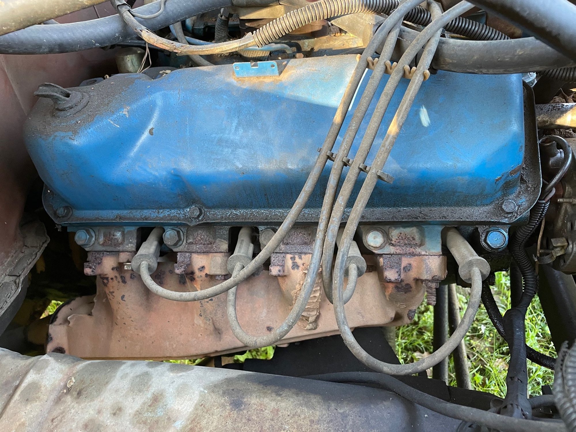

Yes on the 400 if the truck has not been modified to fit an unrelated engine. The 400 is identical in almost every way on the outside. Only the crankshaft and pistons (and rods too?) are changed, so if the 351M was bolted there, the 400 is a straight swap.
But take a pic or three for us just to make sure we're all on the same page. It's very possible that they put a 351M crate motor in, but it would be good to confirm.
Several ways to do this, one of which is counting the number of bolts holding the valve covers down. There are other variations to look for too, but the bolt count is a good start.

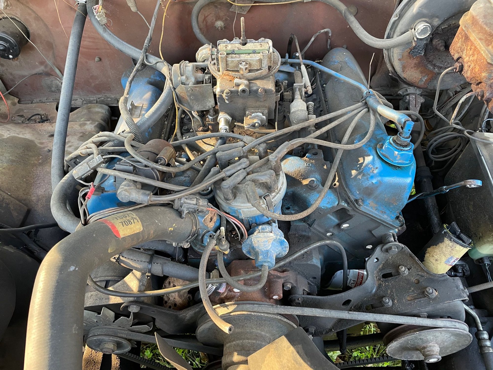

Thanks Paul,
Here are the pics of my engine to confirm.

335 Series. Judging by the lack of a wall, 351C. No truck would have come with the C, so they likely replaced it with one.
1978 351M
1972 351C

What transmission? Divorced/married transfer case? All 351Cs were small block trans, all 351M/400 Big block trans.

I swear. Just has me racking my brain because I would assume the truck came with a C6 which would have been a big block pattern. There appears to be a Cleveland in there from the pictures, so it would have a small block bell housing. The C6 did not have a removable bellhousing if I recall correctly, so the whole transmission would have to be swapped? Seems an awful lot of work. Of course all this is based on the premise that I’ve never seen a 351/400 that didn’t have the wall around the distributor. Last year of the 335 was 82 correct? Did the later model casting eliminate that feature?
