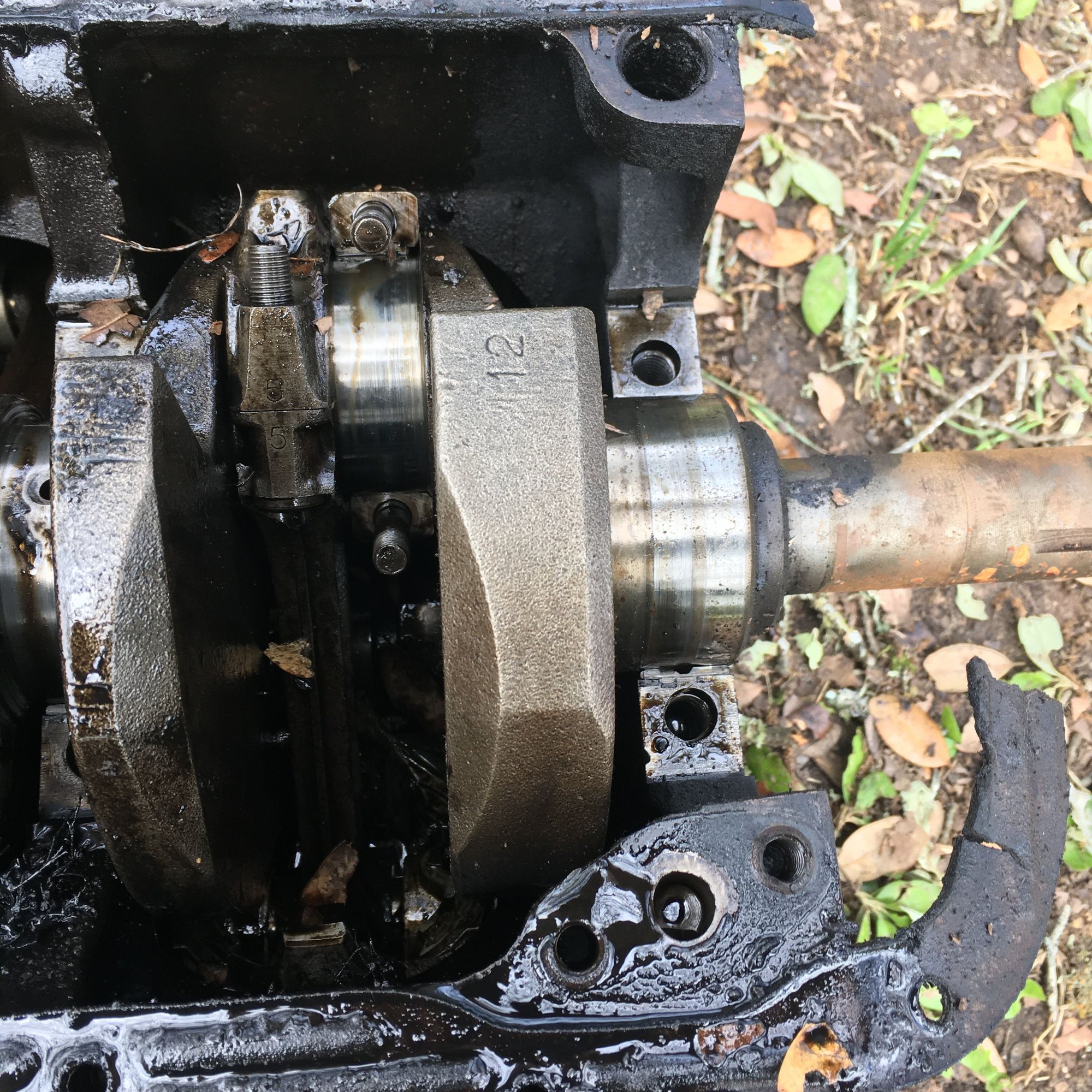

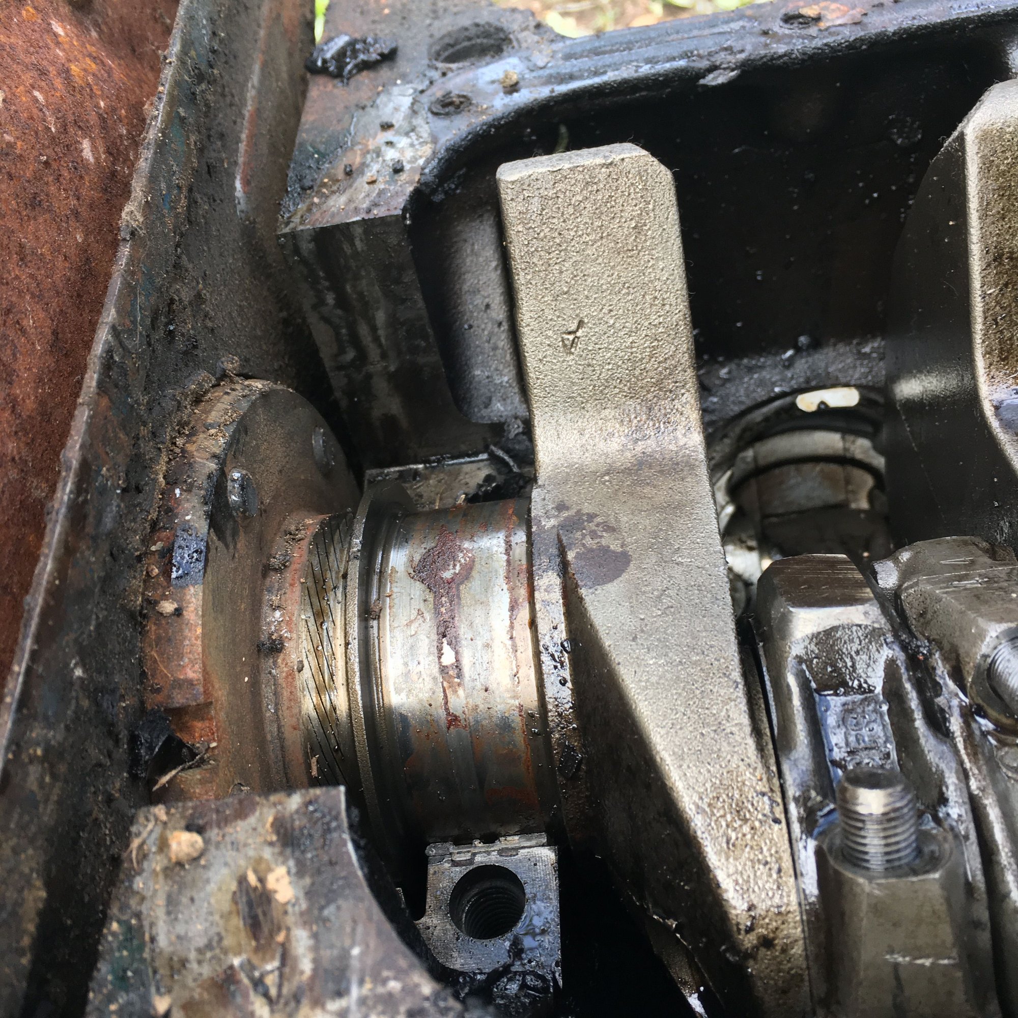

So I am finally tearing into this mystery FE. It’s locked up so removing the crank is difficult. Locked up good, dirt in the lifters as well as in the cylinders. Inside looks clean. So I’m starting from the bottom.
can anyone identify this crank? The “A” is by the rear main and the “12” is by the front main.
malao if anyone has advice for seized engines as bad as this please let me know!

Measure the stroke of the crank.

Turns out it’s a 3U which I have read to believe is just a standard 390 crank.
