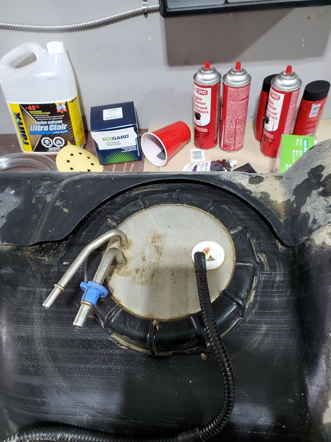

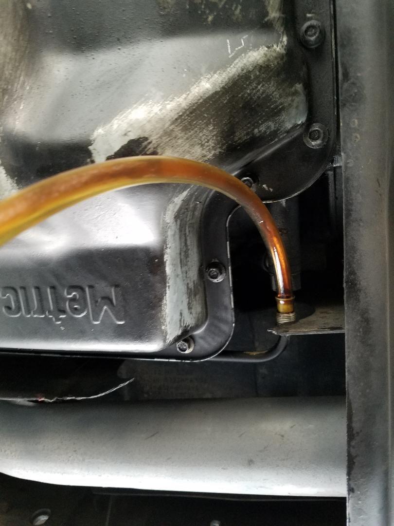

Hutch and harpoon mod
Well just killing a few minutes here while I siphon the remainder of my tank into the jerry can. Last night I did a Seinfeld and went farther than I should have on the low fuel light, about 30 miles or so. Pulled the tank today and there is at least 5-7 gallons left in the bottom of the tank
Edit: after siphoning, no more than 4 gallons in the tank. A good guess is the tank light comes on with about 5 gallons of "usable" fuel left. Or 6-6.5 gallons total.
. Easy enough to manage for weight but I'd rather have it empty for install.

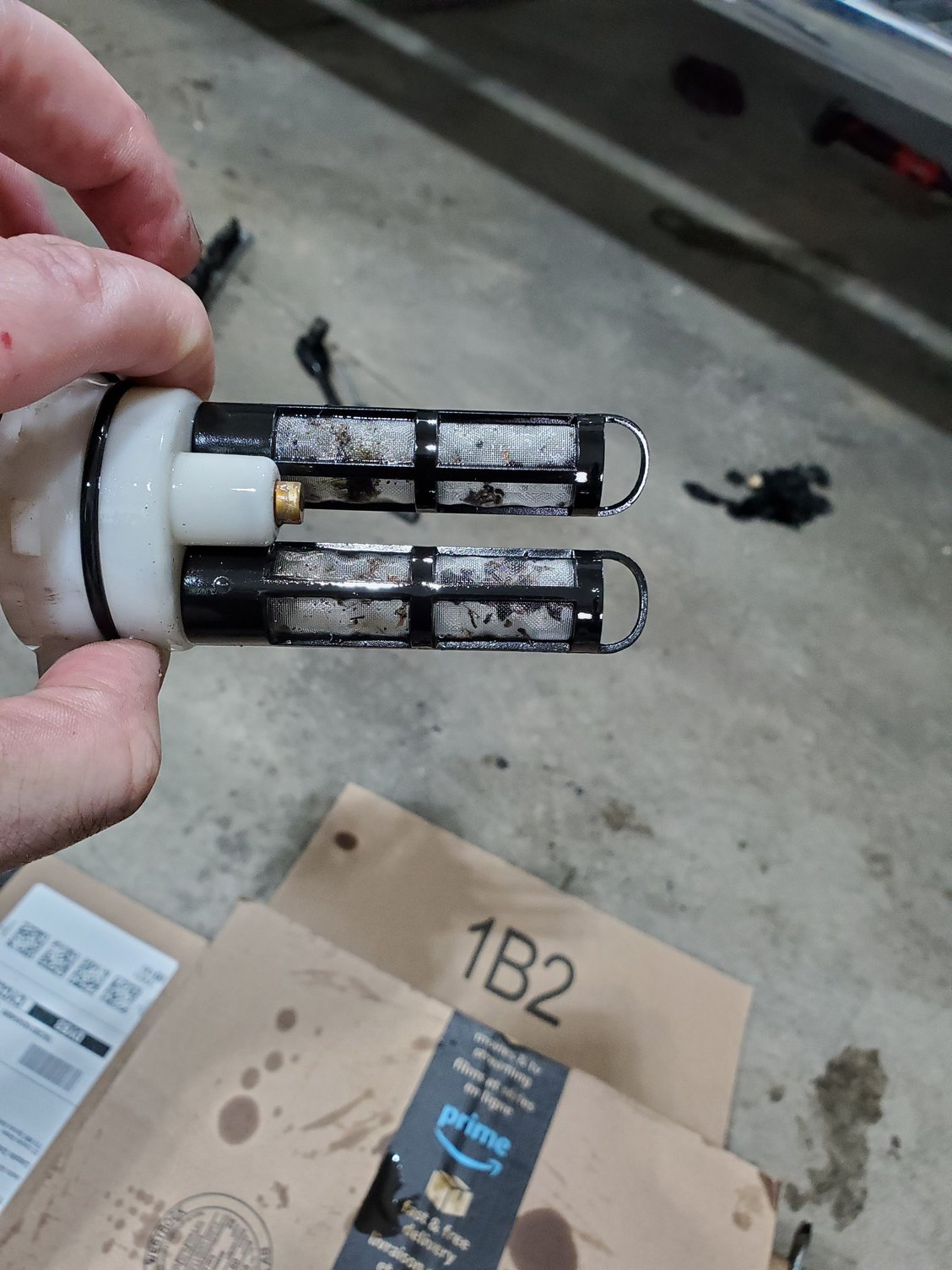

What I found inside...was disappointing. The tank internals were pretty darn pristine. Strainers as well. Oh well now I have peace of mind till the truck gets parked in the bush.
I'm sensing a theme that this truck is still in pretty darn good reliable shape even if I didn't do all of these reliability mods. I struggled a bit with some cheap fuel line removal tools and I broke a rotted old vent line but the tank removal went fairly well otherwise. - For the mod, I'll do the SSJ mods but I haven't bought a single part yet.
Some pics:
Slow siphoning hose, all I had:
Arrow on assembly, pointing to the inside of the truck
Pickup assembly, looking disappointingly pristine:
Internal screens, really clean

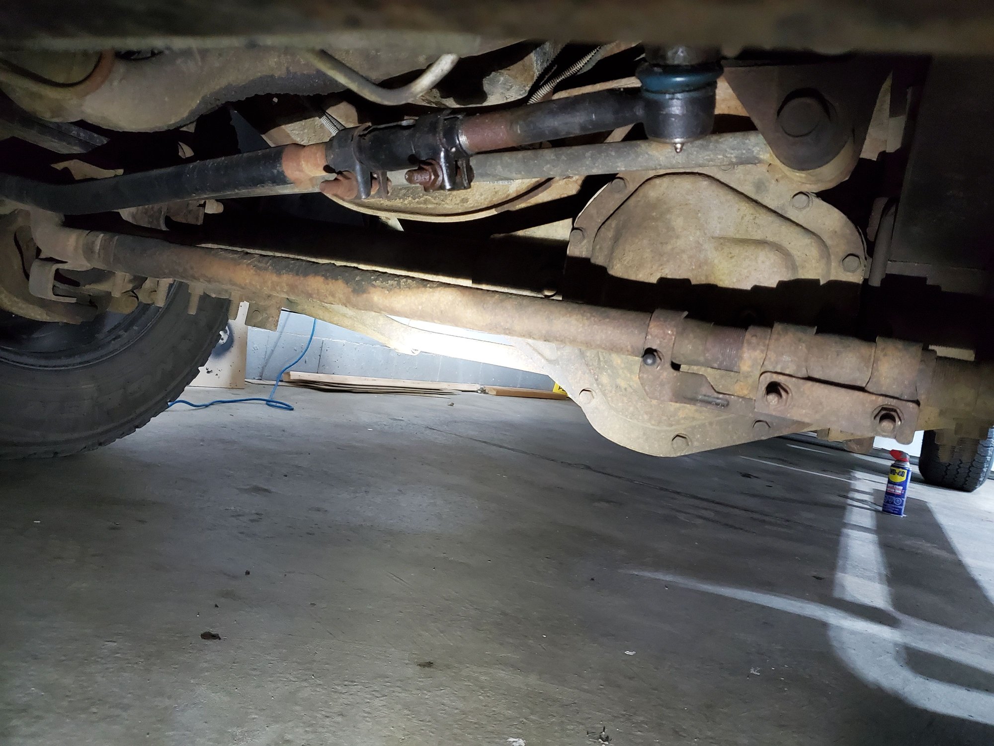

Has anyone added a steering stablilizer to a truck that did not come equipped with one? I'm assuming I would need to purchase the centerline bracket in addition to the stabilizer (shock)?
I've heard mixed reviews, I think properly installed - It wouldn't hurt to have.
What it looks like under my truck:
Installation pic from bilstien:

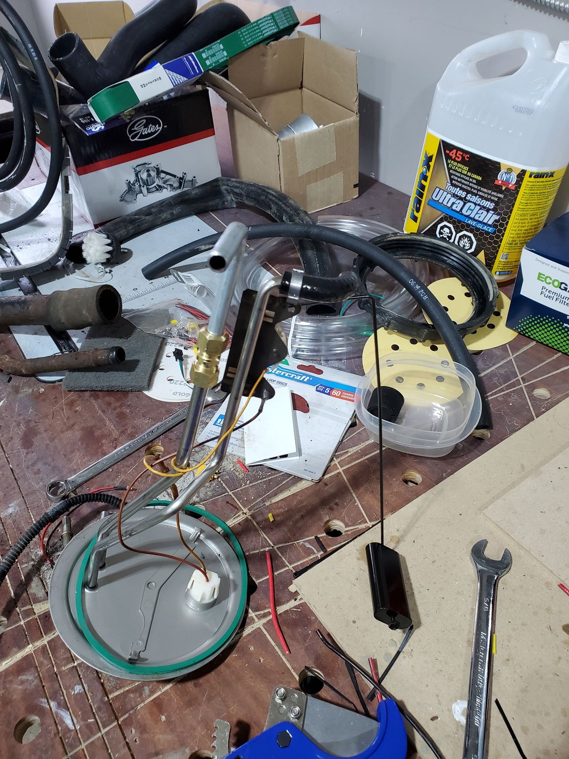

Well the h&h mods are done ssj style. I give this job a 0/10 on the fun scale and about a 5/10 on the solo difficulty scale. Definitely had to have the tank empty to reinstall.
I did struggle for quite a while trying to get that lid back screwed on. What ended up working for me was marking where the threads started on both the tank and the lid. I then lightly coated the threads on both with atf. When I slowly started tightening the lid I noticed it "popped" right where the thread start intersected. I gave it a smack with my fist and the threads were set and it was good to go.
The pre pump filter is on the way along with the fancy hose. Should be later this week.
Getting there!
