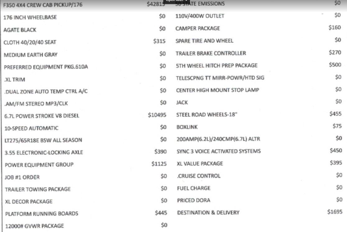

Yes, US, I'll post my build sheet later.
Old Apr 17, 2021 | 08:03 PM
gijoe411's Avatar
gijoe411
Joined: Apr 2021
Posts: 28
Will this truck not have a 12k GVWR??

It says so. I guess they put them at 12,000 since they did the payload recall. I would prefer 12,000 anyway.
I would get the 275/70/18 tire option too to get the rear gawr up seeing you have the GN prep you probably want that. Black side wall or white wall letters they are the same tire.
