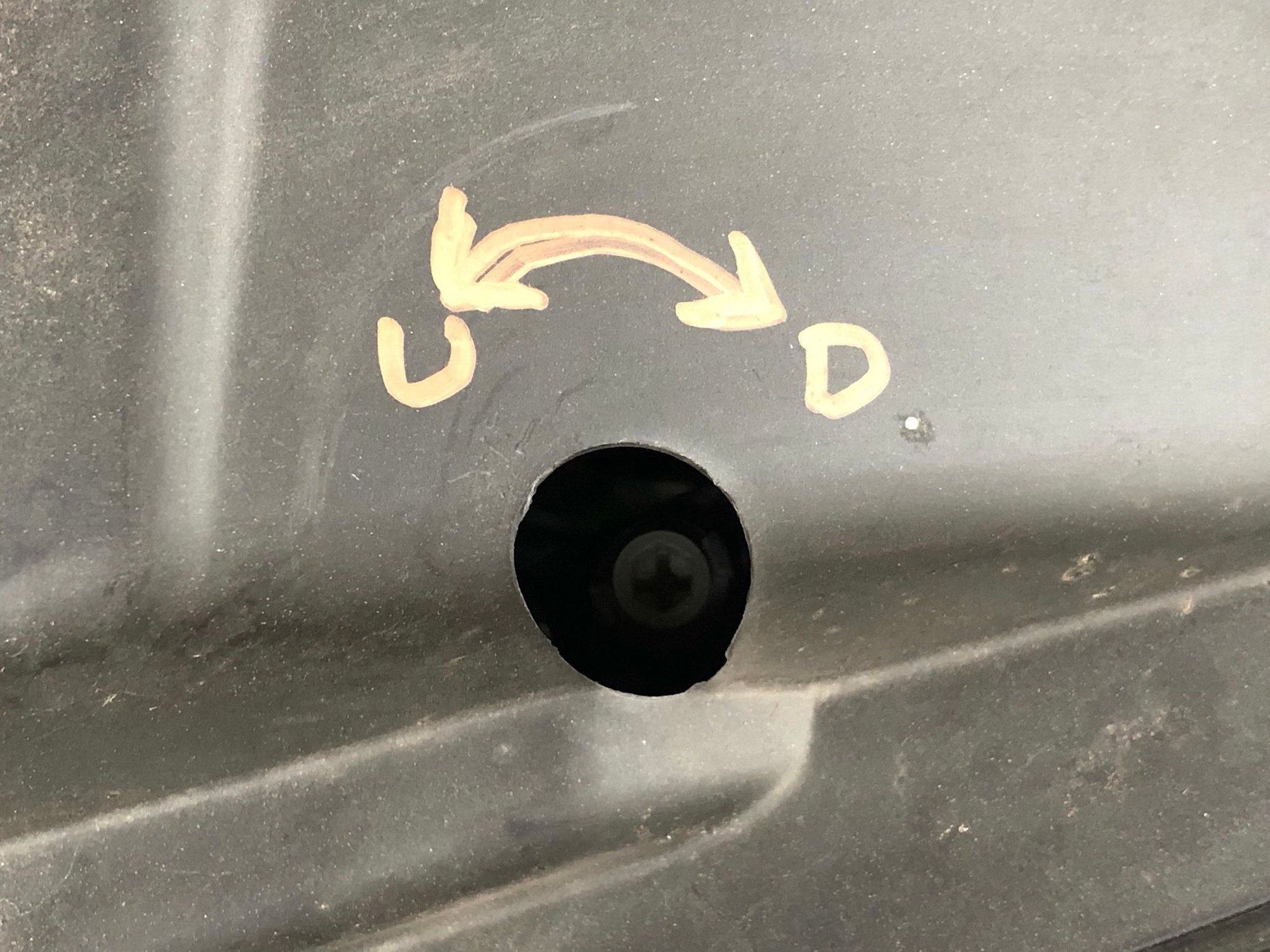

Halogen Headlight Adjustment
I know where the adjusters are (one per headlight) was hoping for a quick answer on which way to turn the adjuster screw to raise or lower the headlights?

Lightbulb
I marked up our 2019.
HTH,

I Assume both sides are the same, correct? Trying to adjust these during the daylight sucks! I just want evenly adjust them by counting rotations.
Thanks again.

My recollection is the adjustment direction is the same for both sides. I only marked my driver-side adjuster.
HTH, and good for you for taking headlight aiming seriously!
