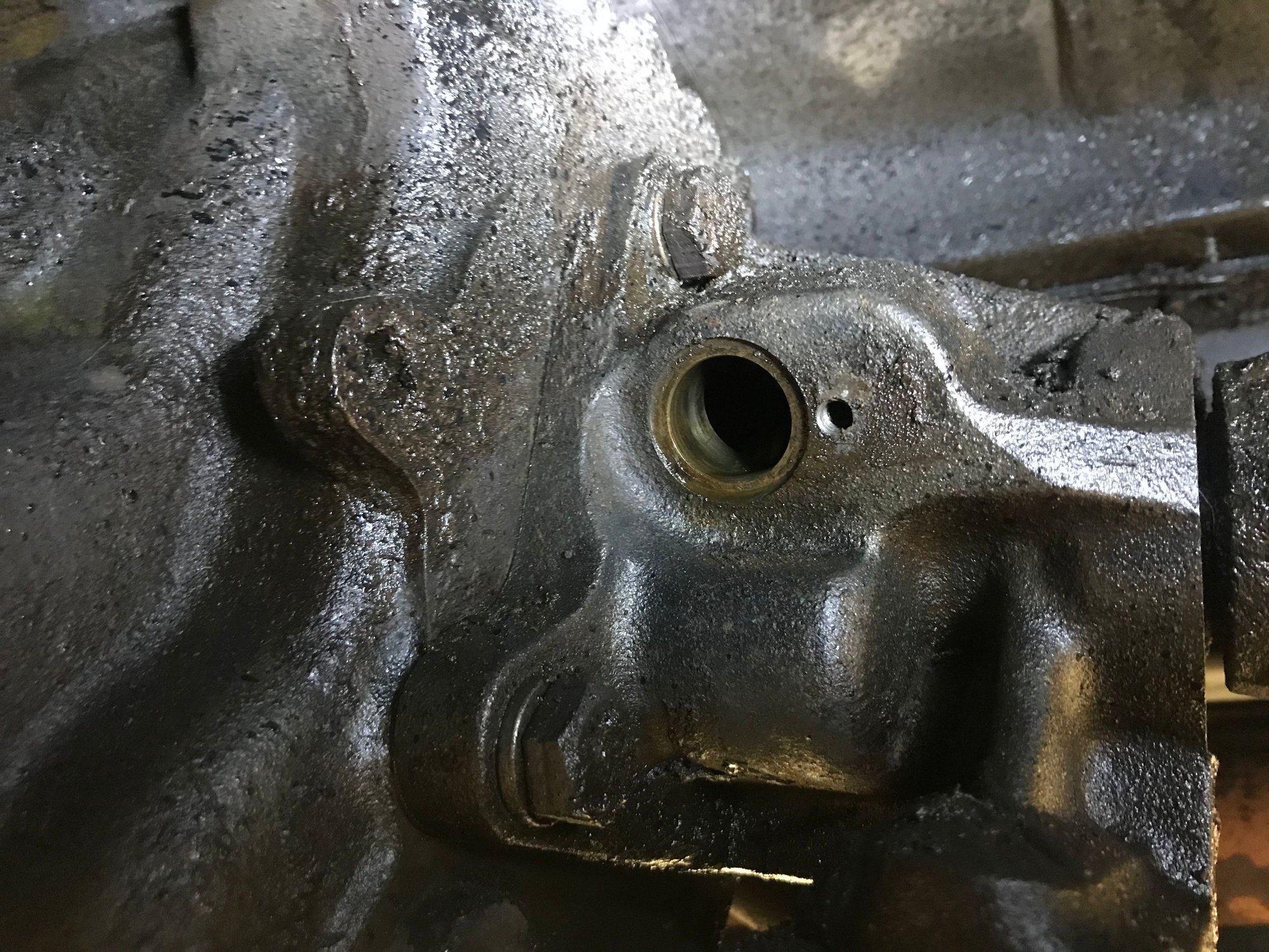

I have recently purchased a 1965 F250 Twin I-Beam Truck.
The previous owner didn't really maintain the Truck at all.
He noted that the Speedo wasn't working. Stuck my head under, and saw the speedo cable wasn't even hooked up, and the DRIVEN GEAR was missing. Not to worry i thought, easy fix once i get it home.How i was wrong haha.
Would anyone know how many teeth on the driven gear i would need? And associated Part #'s?
I'm sure ive heard of an online calculator to work out the Ratio's....

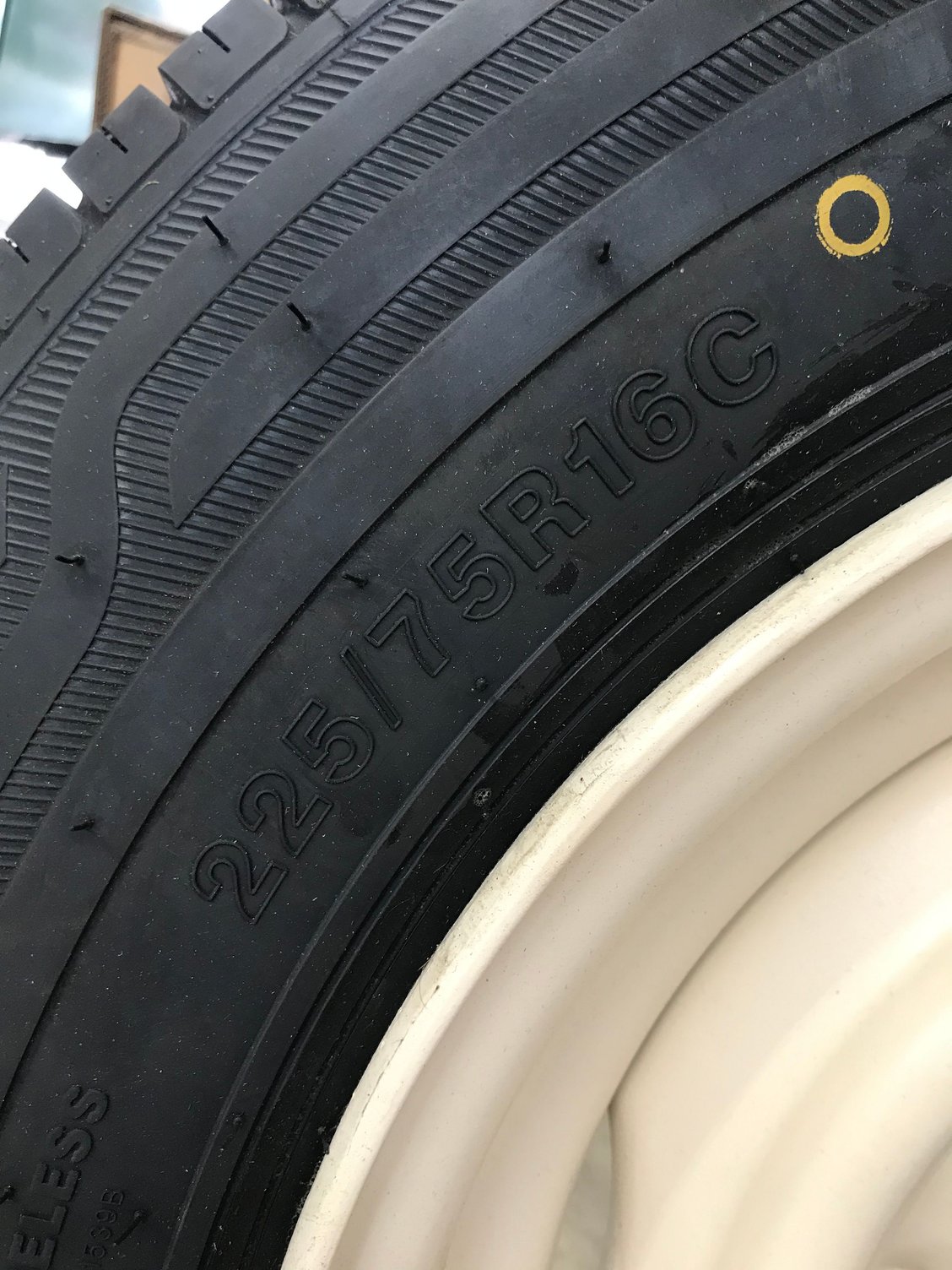

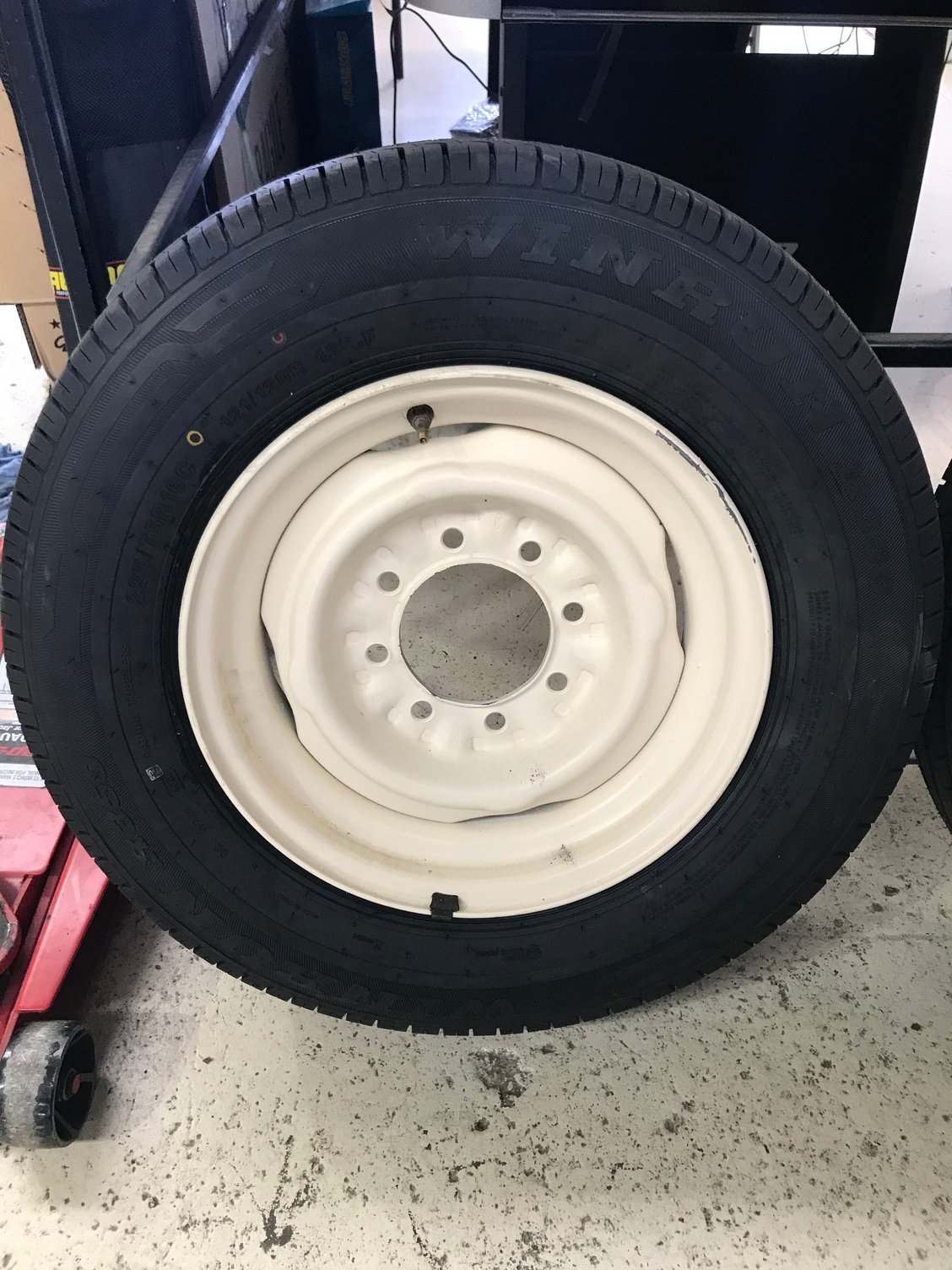

The previous owner fitted new tires before i took on the truck, which are: 225/75/16

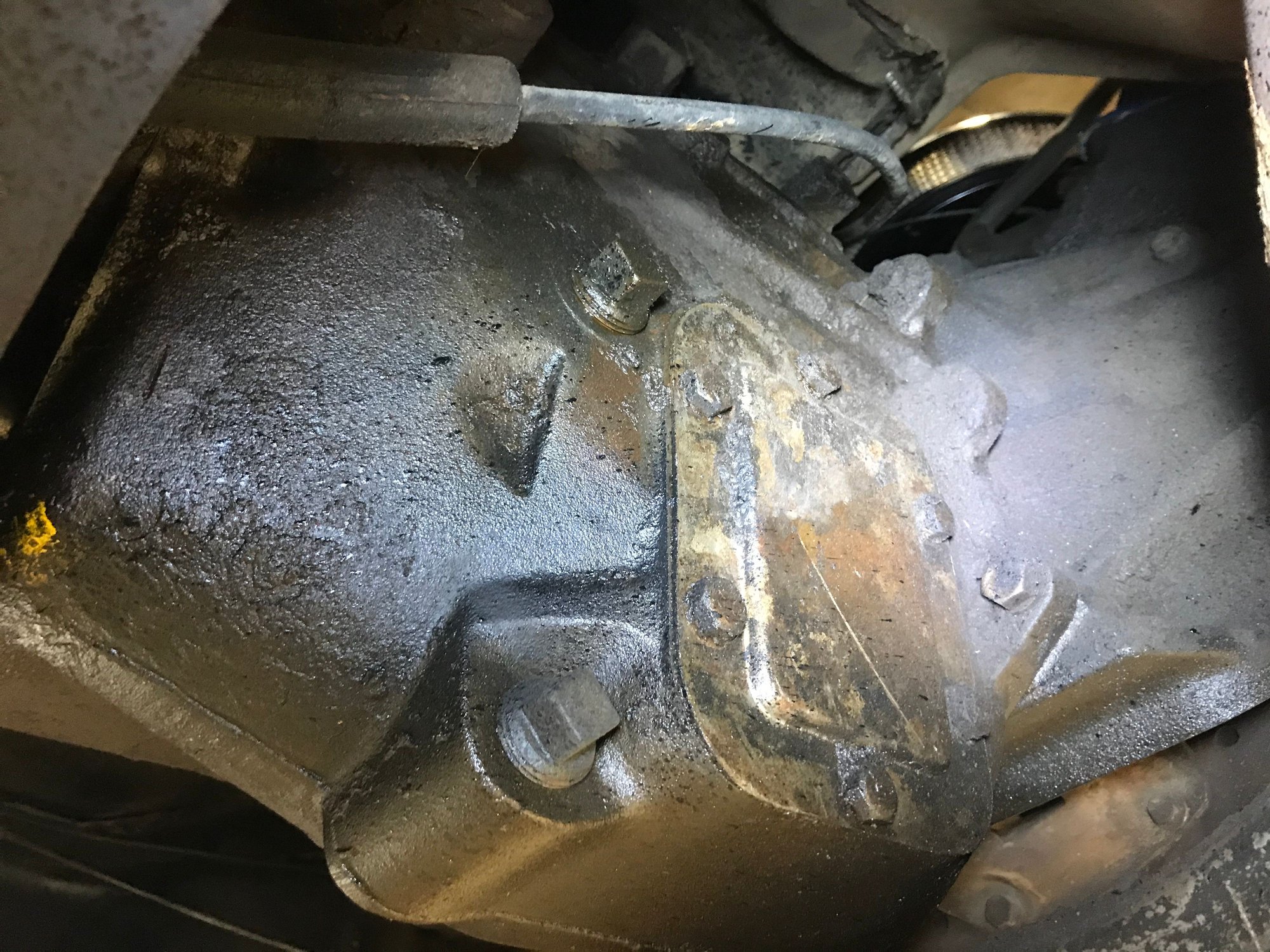

I have attached photos of the actual gearbox, just for clarification to the brains trust.

Not enough info here yet. Need rear end ratio also. Consider this - for just 4.10 ratio there are a whole page of gears (many duplicates) listed depending on tire sizes. Your tires are radials - they only used bias ply tires at the time of the catalog so you may have to buy a couple or three gears to test to see if you can get closer with one gear or another since a radial to bias conversion may not be super accurate.

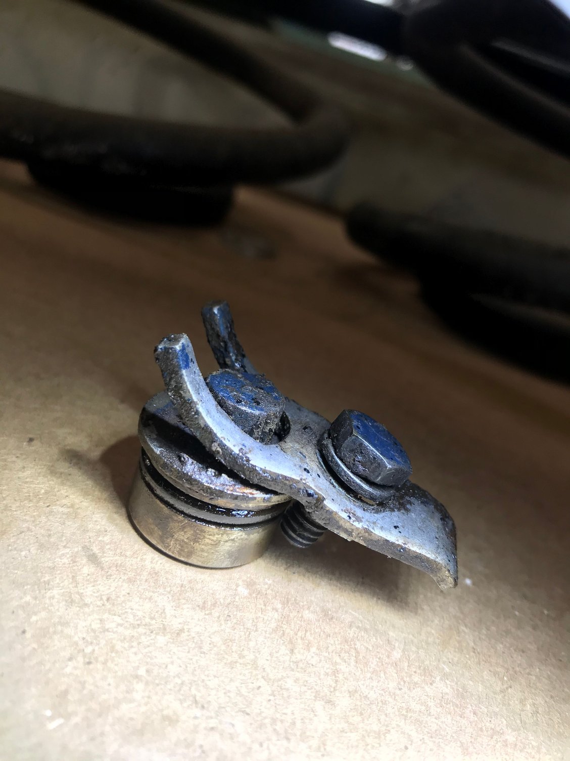

From the picture it looks like the drive gear is pretty messed up which could be why the speedo cable went away.

Does look a bit ground down on the right side doesn't it? Good eye CD.
Here's a close-up of a typical drive gear and you can see the splines are a consistent height across them and width of each except at the very ends where it tapers off. Might be worth a closer look at that.

Once i posted this, i realized i had missed the Diff Ratio, and the tire height!
I checked the Ratio, believing its in the 3.90 ball park.
Tire height is about 28.5 Inches.

CD and 55HO,
I completely missed this. I just saw the Gear inside, said "that's a win that its still there" and carried on. To excited having this thing in my garage to take note of the finer details.
55HO, that photo definitely shows and proves the one in my gearbox is suspect.
