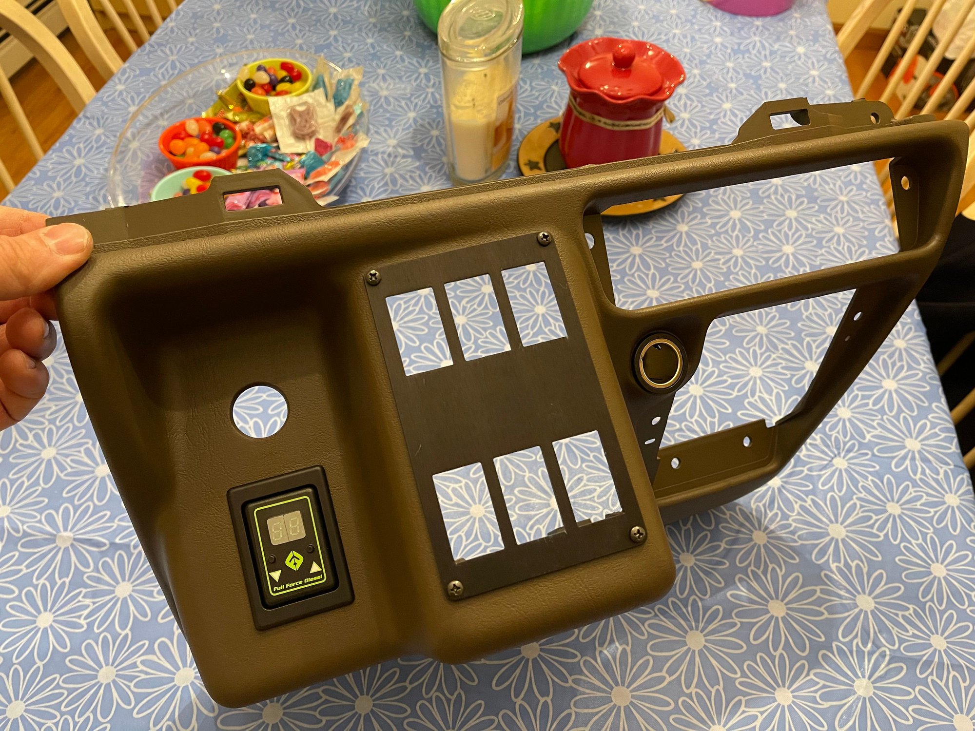

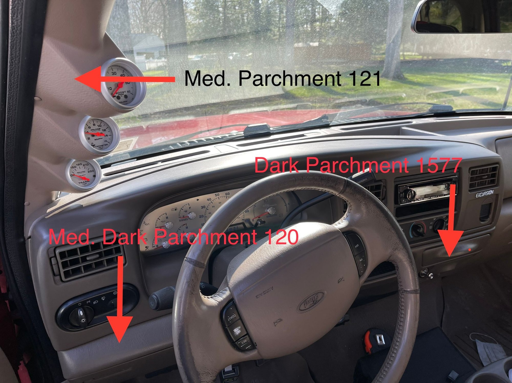

I finally got around to going to the dealer with my Vin to get the dash colors. This is for a 2001 excursion limited. Medium parchment 121, medium dark parchment 120, and dark parchment 1577. These are the numbers for colorbond if anyone needs them. Originally posted in Appearance and Dressup.
Dark parchment on the upfitter panel

Thank you so much this information is awesome.
Screen shot taken as I have the same new lower dash piece that needs paint.

Great post! Is it possible to get a replacement steering wheel with Dark Medium Parchment leather, so it'll match the airbag? The Carid ones only offer Medium Parchment, which is lighter than the stock wheel on my '01.

Late reply but a good automotive upholstery shop should be able to rewrap your steering wheel in any color you want.

When I replaced my dash cup holder, I couldn't find the Dark Parchment so I used the Medium Dark Parchment. It just so happened the previous owner replaced the waste bag hanger panel with the MDP so a matching cupholder looks like a nice match. The colors are so close until you put them next to each other. If I were that particular, I'd have to look for the waste bag hanger panel in the DP. I've already swapped my original cupholder panel into a new assembly but shelved it since I like the MDP accent. Unless you want to paint, the DP parts are very hard to find. I'm looking for a new condition dash panel to replace my slightly damaged one.
