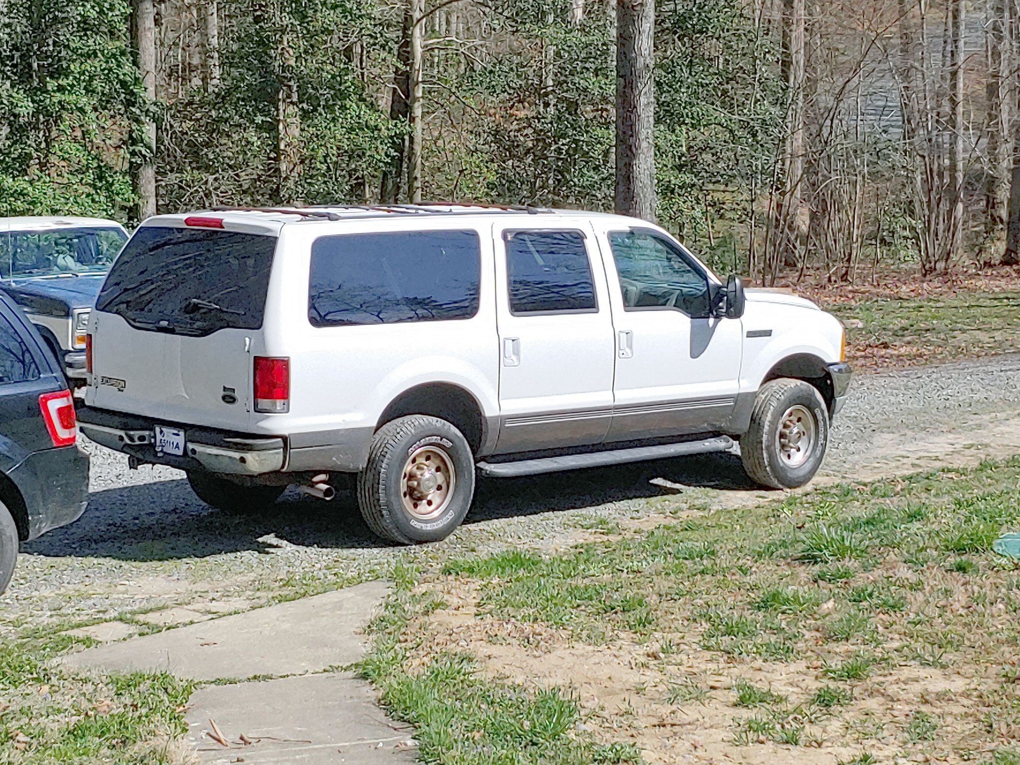

I have a 2001, 4x4 Excursion.
What are some good shocks for a smooth ride? I don't care about towing capability yet (I have nothing to tow at the moment), but would really like to treat my motion-sickness prone wife to a comfortable ride. I have a few inches of lift, but I don't know anything about lifted trucks... like I'm not even sure what size shocks to buy. Thanks!

Bilsteins! 4600s! Absolutely the best! I’ve got Z codes up front and the ride is smooth.

I also like my Bilstein 4600's. if you have any lift get front F250's, stock length is good for the rear unless lifted really high.
KYB Monomax are also supposed to be good, but my only experience with them was a worn out set that got quickly replaced.

KYB Monomax is very good for a stock height X. Unfortunately, if yours is lifted, no dice.
What are your measurements on all 4 corners from center of hub to fender?
I have a set of Bilsteins on now and I like them, but they are a bit harsh. The 4600's might be a bit softer.

If your lift is very mild, an OEM style replacement shock would work fine. IIRC, when you get over like 2.5" of lift, you need an extended shock. But I wouldn't have a clue what to recommend for strictly ride comfort. My rig rides like an empty dump truck. Maybe call a couple of local off-road shops and talk to them about it.
All that said, the way Excursions came from the factory, it was discovered pretty quickly that the suspension was very under-developed.

Thank y'all for helping me make an informed decision. I went with the Bilstien 4600s on the front and am very happy with the improvement. They were a bit harder to find for the rear, but will be going in soon.
