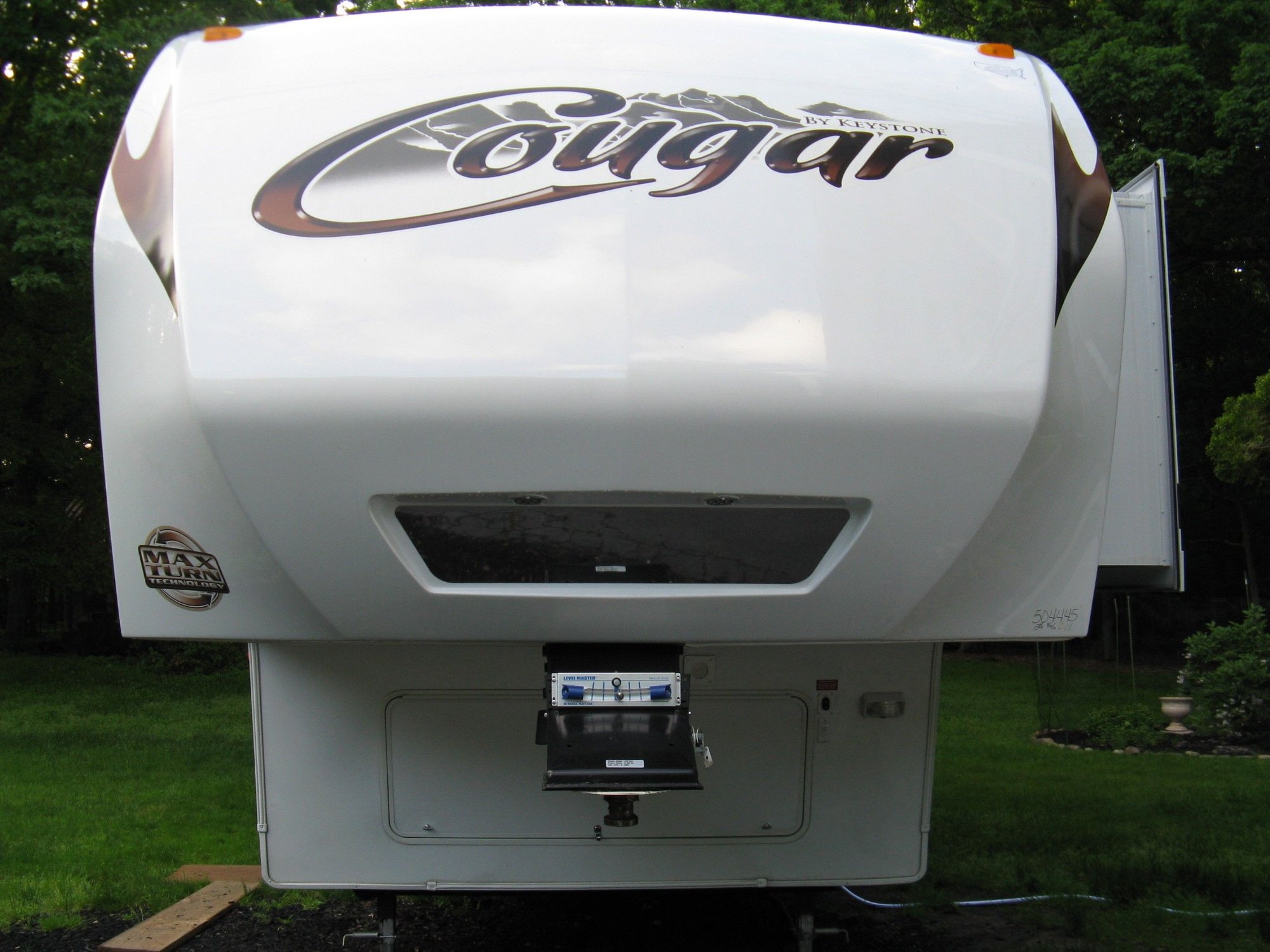

MAYBE I DON'T EVEN NEED A SLIDER IN AN F350 SHORT BED.
MY 318SAB COUGAR HAS A PRETTY SEVERE CUTAWAY ON THE SIDES OF THE FRONT CAP.
WHAT DO YOU THINK?

@PhilKash Naw, you don't need no stinkin' slider.

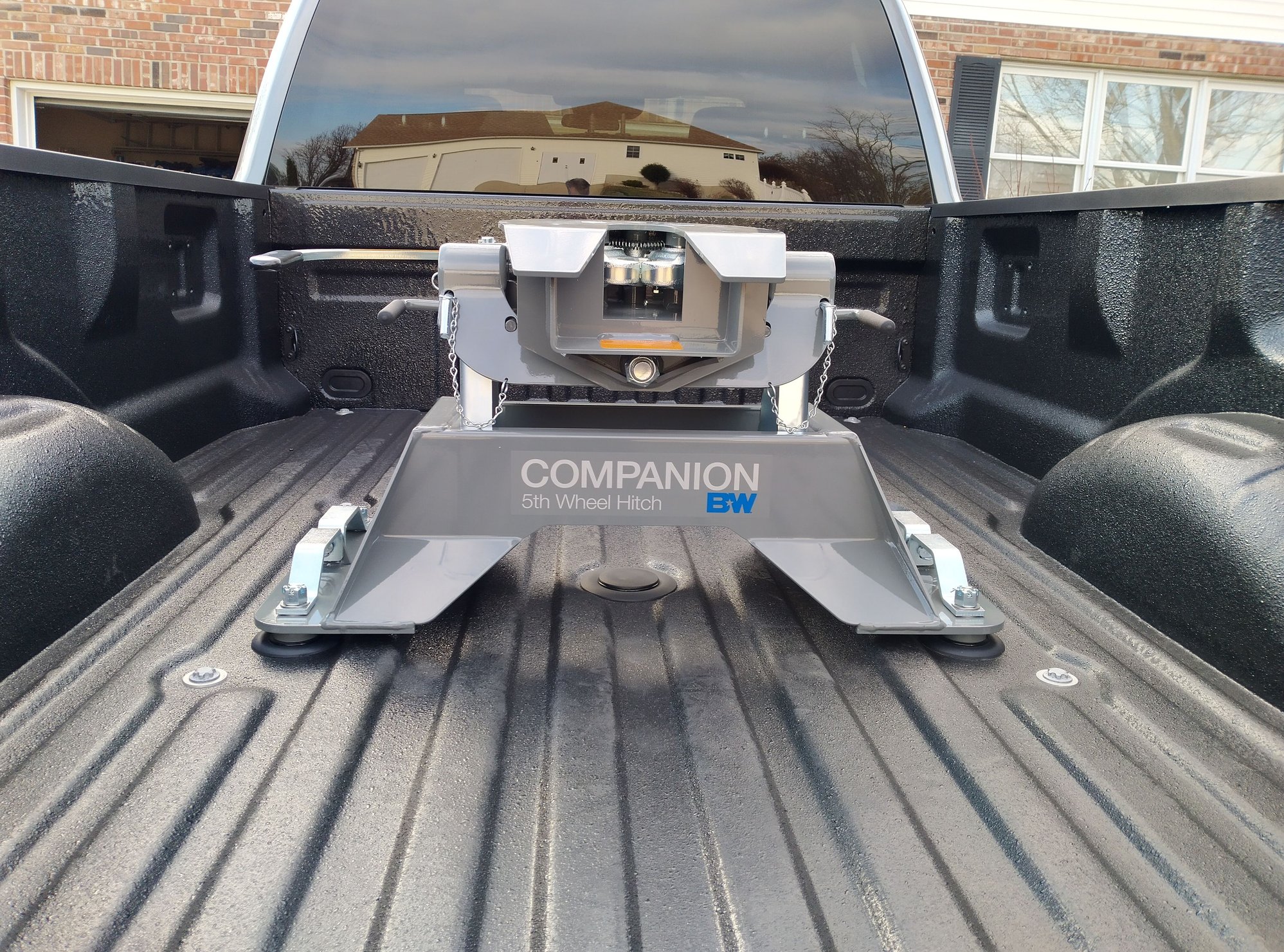

After much research this is the setup I went with. eTrailer had best price with free shipping. Can't beat it.
Originally I wanted to swap out the box with a Reese Gooseneck box but my RV dealer (Grand Design) said they may or may not honor your warranty if something fails. On a new rig I didn't want to take the chance. Also, he sells the Reese Goosebox for $2200 where I could get it from eTrailer for $1430. Issue is they won't install what they don't sell and I need something to pull the RV home when it comes in, so back to the best made fifth wheel hitch available (IMO). I'm sure others will get the job done but the B&W is stoutly designed and manufactured.
