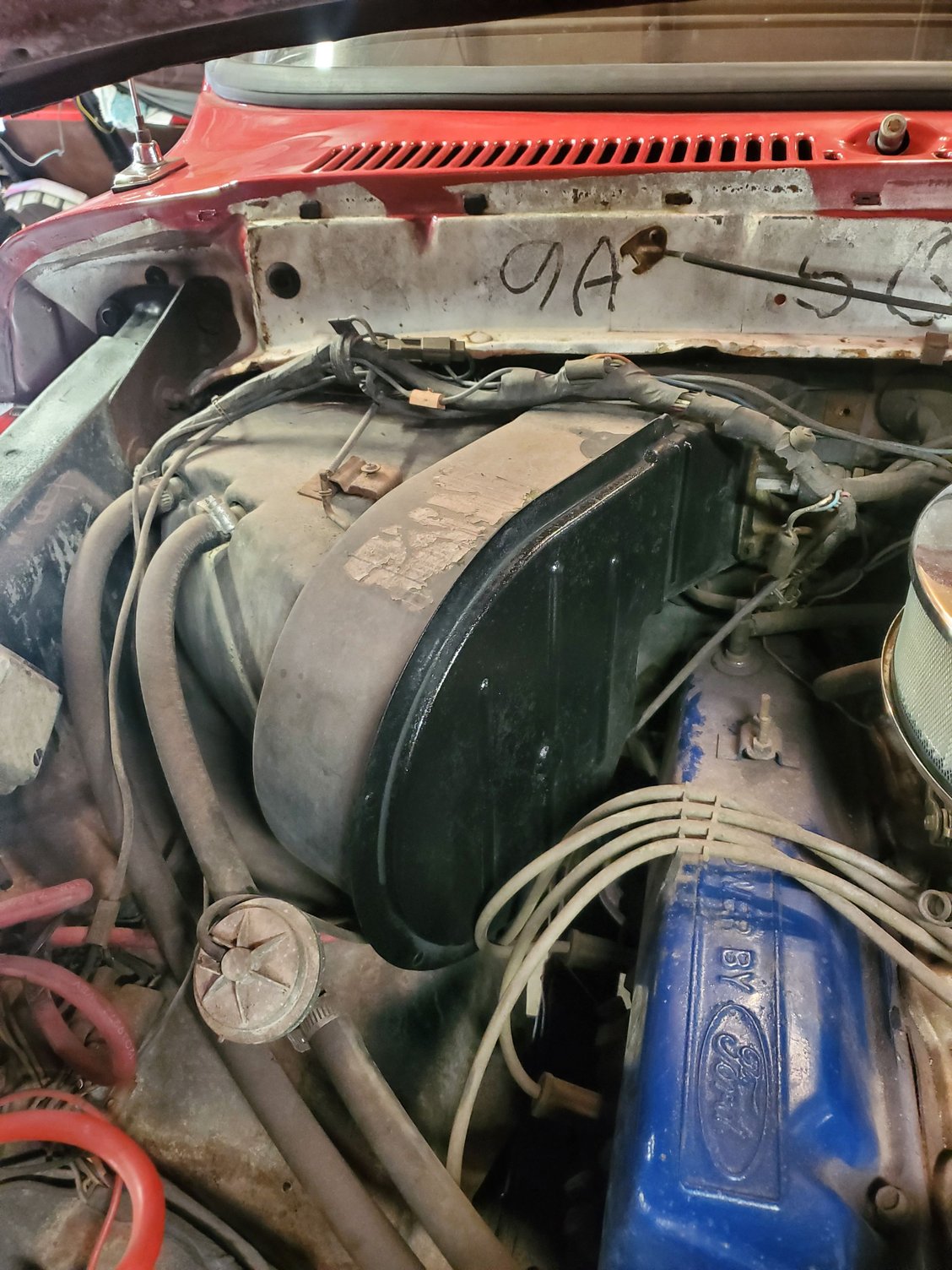

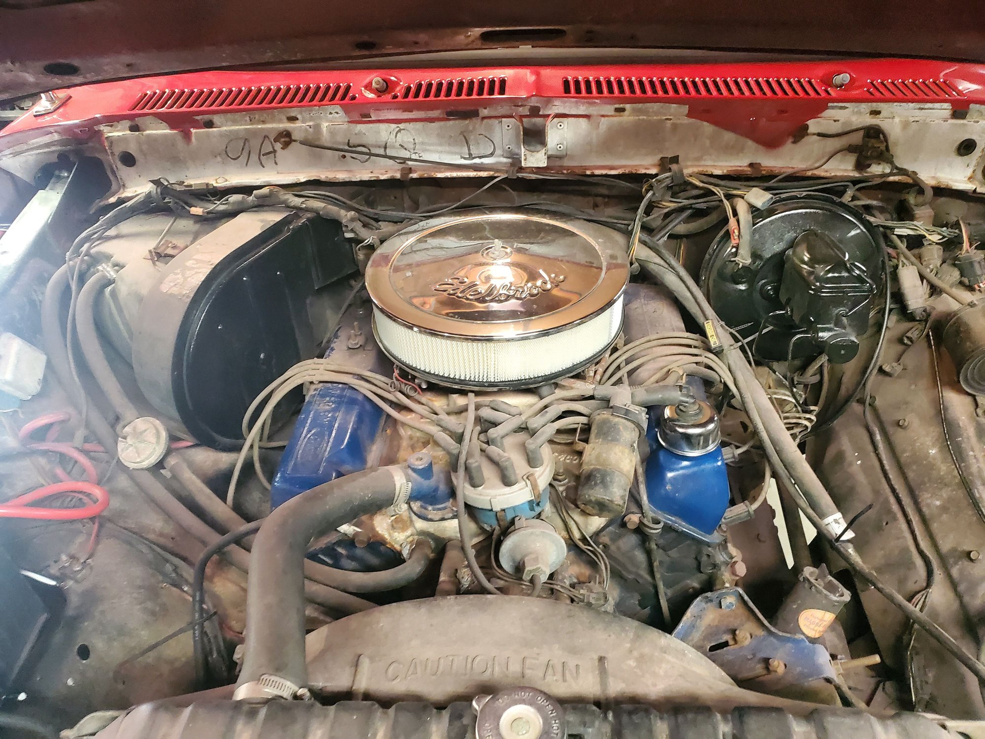

Unfortunately I'm a dummy when I comes to heating systems. Is this the valve you speak of? Has a hose leading to the firewall. Is this a vacum operated valve that opens and closes the flow of coolant to the heater core?

Your truck does have a heater shut off valve. When the HVAC is set to cool the valve closes to prevent engine coolant from going through the heater core.
So with the loss of engine coolant cooling from the heater core the engine starts to over heat.
Now you never said if this was at idle or while driving.
If you are getting this issue while idling you likely are not getting enough air flow through the rad or the thermostat is not opening.
If this is an issue when you are driving then the rad may partially be blocked and or the thermostat is not fully opening.
When this is happeing is the upper rad hose getting hot ?

It seems to only be while driving. I warmed it up in the garage today and it didnt do it. Upper hose was hot but again that was at idle in the garage with normal temp showing on the guage.
Coolant is maybe a little low, about 2 inches below the cap level. At this point I think ill replace the thermostat, flush the system and add a coolant overflow bottle to make sure it topped off. Probably should be done anyway.

And what's this do? It's not attached properly like many other things in this truck. Always fun finishing someone else's project

I stopped by a wrecking yard and was able to see that this is connected to the warm/cool lever and must work in conjunction with the valve to control heat? Mine doesn't appear to be hooked up on the other end.
