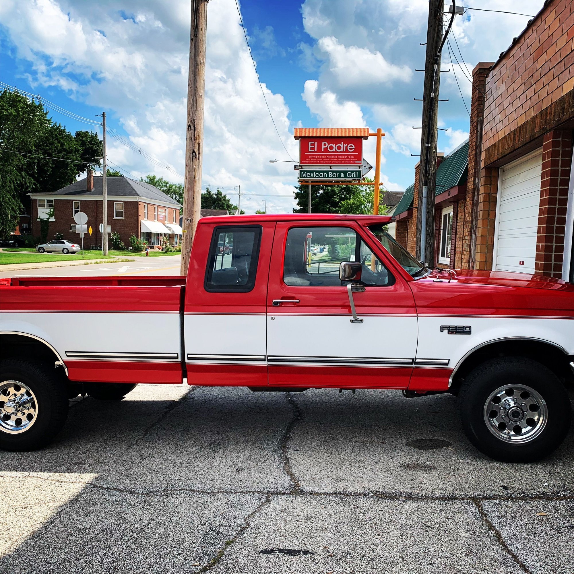

Hello All,
As an older gentleman it is tough for me to get in and out of my 1995 F-250 SuperCab. My question is, how can you tell if the vehicle has been lifted? Or, what is the standard height for the truck? Both my wife and myself have trouble getting in and I wonder I’d the truck, newly purchased, has a lift kit on it. It has 235/75/16 tires and 8 lug rims. Thank you in advance for all your time and help.

It has aftermarket wheels and tires on it that may be larger than factory but it looks stock otherwise.... reverse arch on the front leafs for example.
What size are the tires?

That was the stock size I think, check the decal on the drivers door pillar.
A set of running boards might help improve access.

I think 235/85/16 was stock factory size. The truck looks stock to me. A lot of them have running boards to help us seniors get in.

Correct that is the stock tire size. I agree it looks like it is stock height. Running boards would be the ticket.

That is a very nice looking truck, nice find.
It looks fairly stock height to me as well. The stock tire size is as above - 235/85/16. The 235/75/16 are fairly smaller, by almost 2".
I have the same issue, and mine is slightly higher in the front with heavier springs. I am installing a hand hold on the A pillar for my wife to use getting in and out. I may install running boards as well. Im not sure what else you can do about it...

Thanks everyone! Hood to know she is stock. I think a good set of nerf bars or running boards will be just the ticket for this old man! Have a great weekend everyone!
