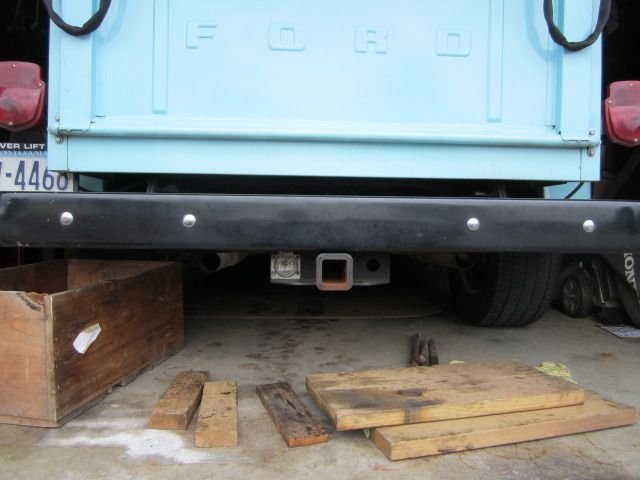

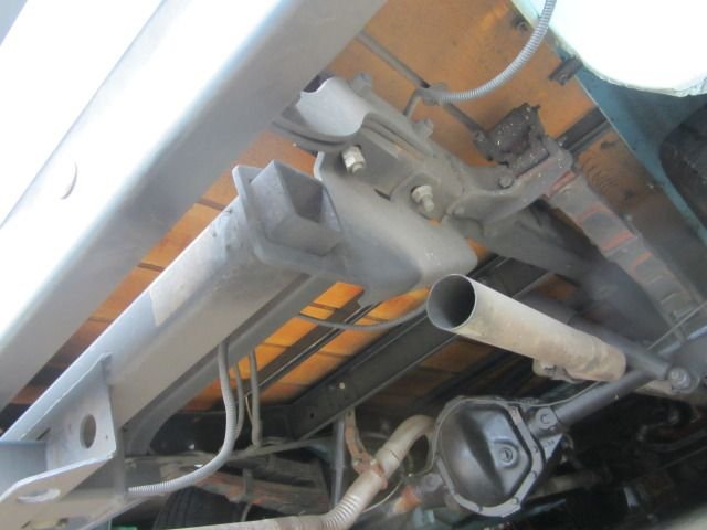

I just installed a receiver hitch on my 49. I'm not sure what it came from, a friend donated it to me. I think it was from a mid 70's chevy truck but I can't say for sure. It is for a 34" frame width and is the type that the side frame brackets can be bolted on to either side so you can change the brackets to have the flange face inwards or outwards for different frame widths.
Naturally, neither configuration worked with my set-up. I had to add 1/2" plates between the center section and the side brackets to work with my situation.
I'll try to take pics when I get a chance
