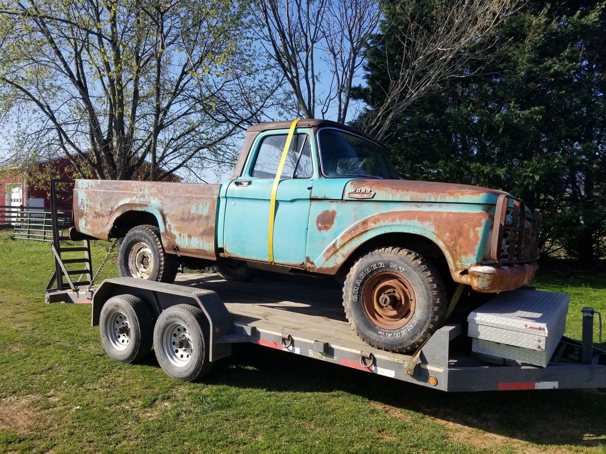

So I drug this home on Good Friday, and the wife named her "Lucky". Partially because the last person who titled her had the last name of Lucky, and mainly because she's lucky not to be in a scrapyard somewhere by now. 1964 F100 with a 292, appears to be correct by warranty plate. Seller threw in a "new carb" he had just bought for the truck, no mfg, part #, stampings whatsoever other than a box marked "Made in China" - wreaks of Amazon to me. That doesn't sit too well with me, dropping Chinese parts on a '60's vehicle, so I'm looking for an original 2 barrel for the truck to see if she'll run. Anyone here have a 2 barrel laying around they would like to sell, or suggestions on where to find one? I'd just as soon buy one that needs rebuilding, so I know where I stand when it's bolted on.
