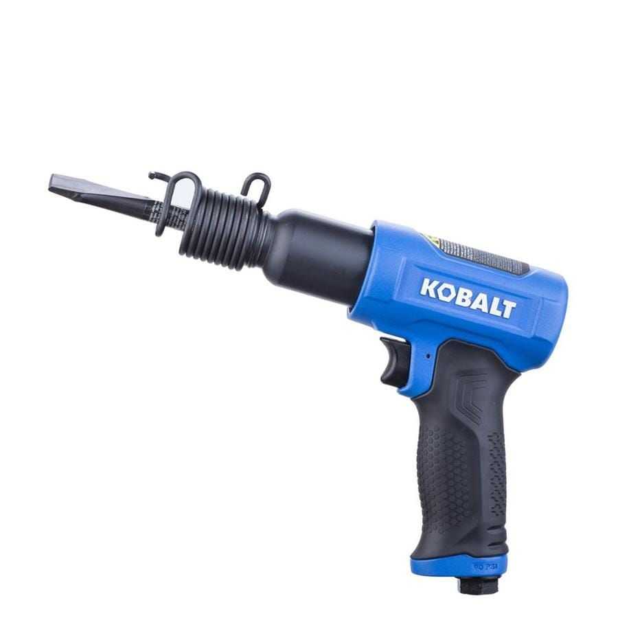

Put all you can on it with your 20T press, then use a buzz gun for some rat-a-tat vibration
You will be surprised what it will do.

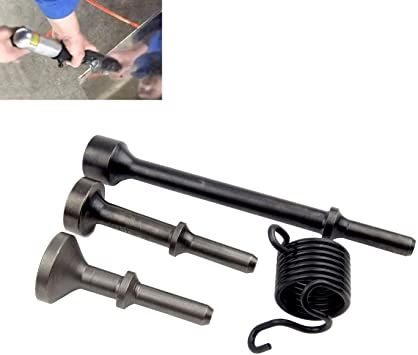

The suggestion above for press + air hammer is equally good. Mayhew sells those "hammer head" attachments, available on Amazon.
Not to be insulting, but you did remove all the c-clips, yes? After that it's just press, vibration, repeat. If that fails it's press, heat, vibration, repeat. If that fails it's cut the cross and go from there.
Go ahead and spray some penetrating lube, even if it's only on the tiny bit of cap you can see *inside* the yoke ears. Then at least as that one is being pushed out it'll drag some lube into the hole with it.
