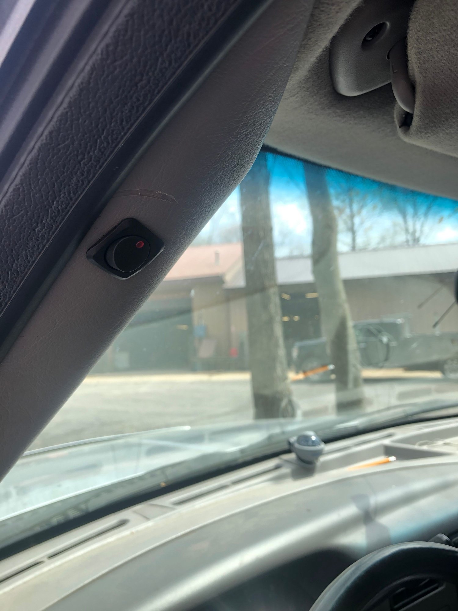

I likewise wired a battery tender to two of my 7.3L super duty's after reading a post on this forum in 2018. 2.5 years and going strong. Waterproof shockproof tender mounted behind grill so I can see status lights. Wired to passenger battery with waterproof plug in front plate bracket. spliced to block heater with switch on pillar arm for cutting heater in warm months. One truck is property maintenance and plow 250 the other is a service body on 350 that also runs inverter to charge cordless batteries.
all parts bought form the longest river in south america.Absolute ANL100-2, 2 Pack ANL Fuses 100 Amp Gold Plated
1 of: 4 Gauge 25' BLACK and 25' RED Car Audio Power Ground Wire Cable 50' ft
2 of: Marinco ParkPower 15A, 20A, 30A & 50A Power Inlets
2 of: Gardner Bender GSW-50 Electrical Square Rocker Switch, SPST, ON-OFF, 16A/125V AC, Spade Terminal, Red Illumination
2 of: Battery Tender 022-0157-1 Waterproof 12 Volt Power Tender Plus BatteryCharger
