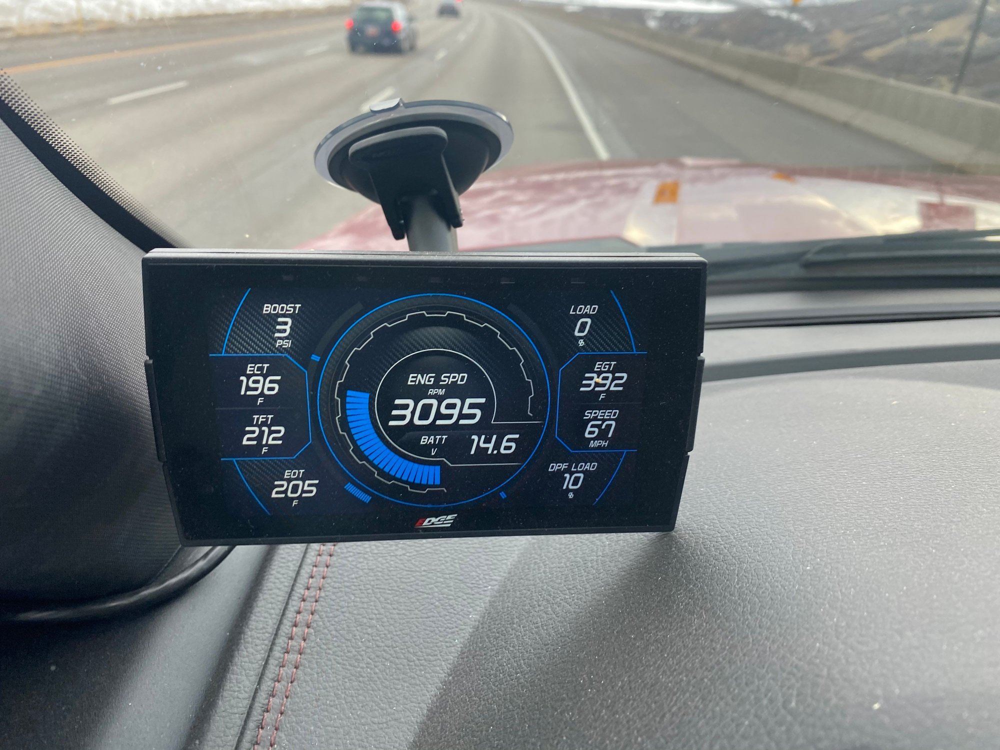

Regen has become a non-event just let the truck do it when it needs to be done. Hence Fords decision to not notify the driver when it happens.
I use the Edge CTS3 to monitor the stuff the dash doesn’t show.
Good for you Painted horse. You don't have that dreaded @n@l disease I do...
I can watch EOT and TFT on the truck gauge but I do watch the ECT on the iDash.
I see you are monitoring DPF load % so you will have a good idea when she goes into regen I'd assume.
