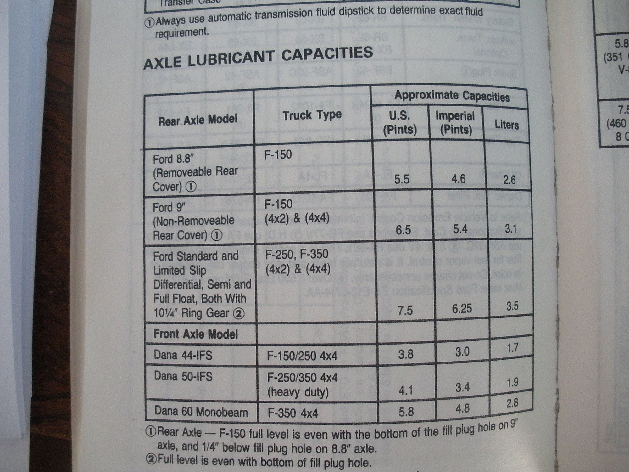

Thinking old school, wouldn't it be cheaper to get something like 3.90 or 3.73 gears ?
Is this going to be daily driver or just used when needed ? Just thinking cost virus benefit...
Do we know which read Diff you have ? Here's the page from my 86' owners manual. I gather you have 10 1/4" ring gear ?

Sorry, it's an 80 not 86. Dana 70 axle.
