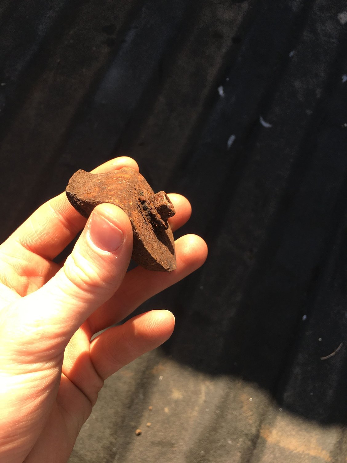

Found this in the bed. Anybody know if it’s supposed to go to something?

The piece of metal you have in your hand could be part of a spring shackle. I would definitely check them all out just to make sure you are all safe to be on the road.

Nah, it's got a tiny (maybe M6 or M10) nut in the center. Nothing on the leafs that small. It appears to be some sort of keeper or retainer but I can't place it
