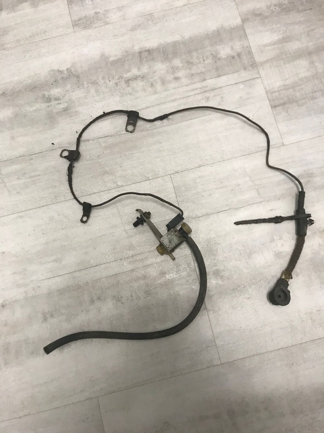

I found the wire that connects to the tranny. What does this thing do? Anyone know?

That is also part of the spark control system. One of it's vacuum hoses would have gone to the Dizzy. I don't know what Ford's purpose was for this system. Too much has changed since 1972. Like our current gasoline. I would just delete this system . But keep the parts just in case you are chasing a spark knock in the future.

Other manf. IIRC also used a spark control on their motors.
I want to say it would retard timing by blocking off or bleeding off vacuum to the dist advance unit.
It was used to meet smog regs back then.
Unless going for 100% restore most just remove it as Jeff said.
