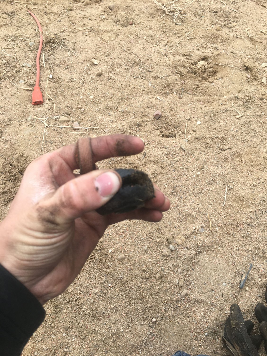

It stayed this way for a while without major changes. And you may not think this is a major change but if you were in the truck you would understand. I changed sway bar bushings on both axles and to the frame.
You can kind of tell from the picture it is completely rotted out. This is just one of the 8 on the links and 4 on the axles. All were very similar
my goodness the ride difference was amazing to say the least! So much smoother. If you have not done them yet, please do. You will thank yourself

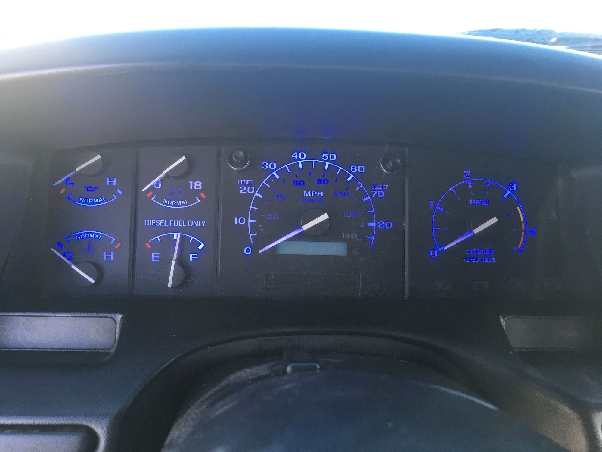

Did a little interior work, including blue LED dash lights recommended by Kahn and a double din radio kit.

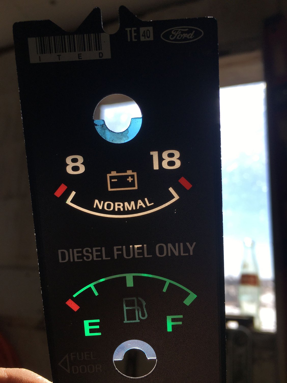

the dash lights were rough. Not the lights themselves but since I went with blue because I wanted a little change I cleaned all the green junk on the back of the dash clusters. It took about 2 hours lots of q-tips and acetone. I had to adjust the gauges a couple times after that but I couldn’t be happier with the result.

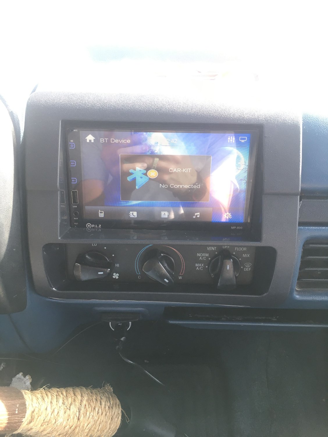

the radio was pretty simple. Quick wiring and dash cut and it’s in. Still have to wire up the reverse camera which won’t take long just got to find a day

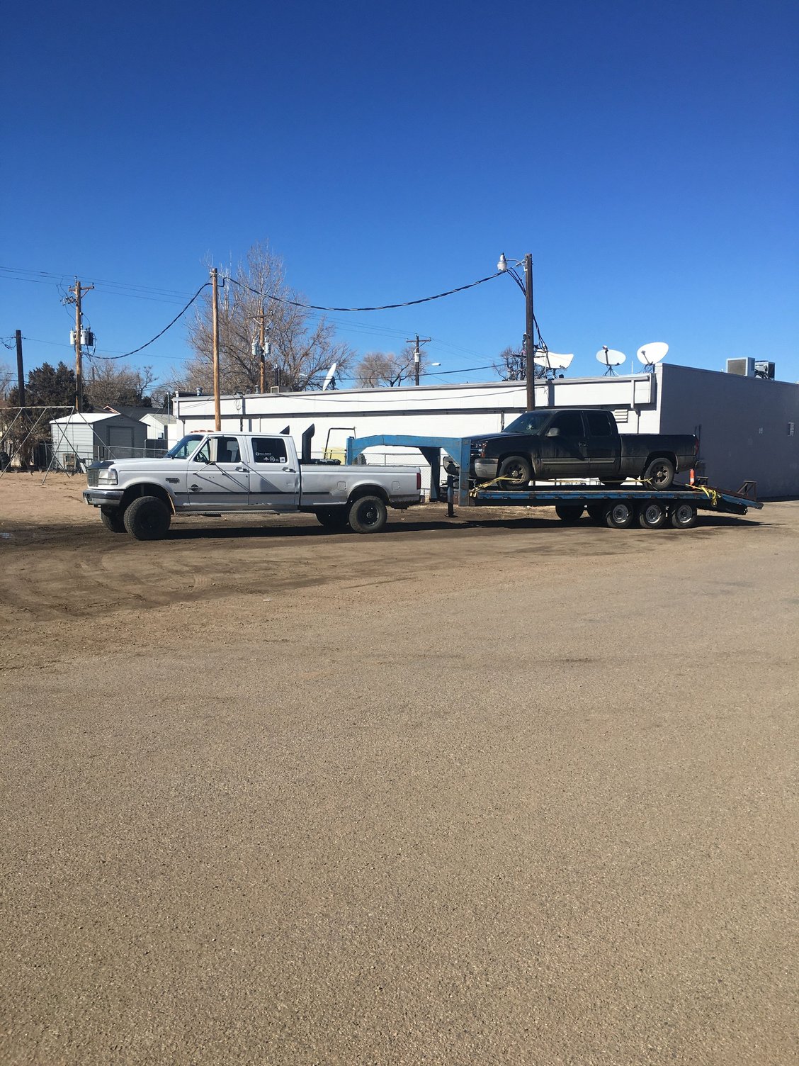

And my first time hauling a gooseneck, of course it’s a Chevy. I had put the stacks back in because I just missed the look and the deep throaty sound but I messed up the downpipe so it was against the fire wall making the cab VERY noisy so the exhaust kit was coming soon

I do like those blue lights! Nice change.

thank you I do too! It was worth it. They are still dim-able as well which is awesome

I'd like to do the blue leds like you've done. Looks very nice.

how were EGTs while towing the Chevy?

surpisingly good. Nothing really over 1000. Hills or accelerating
