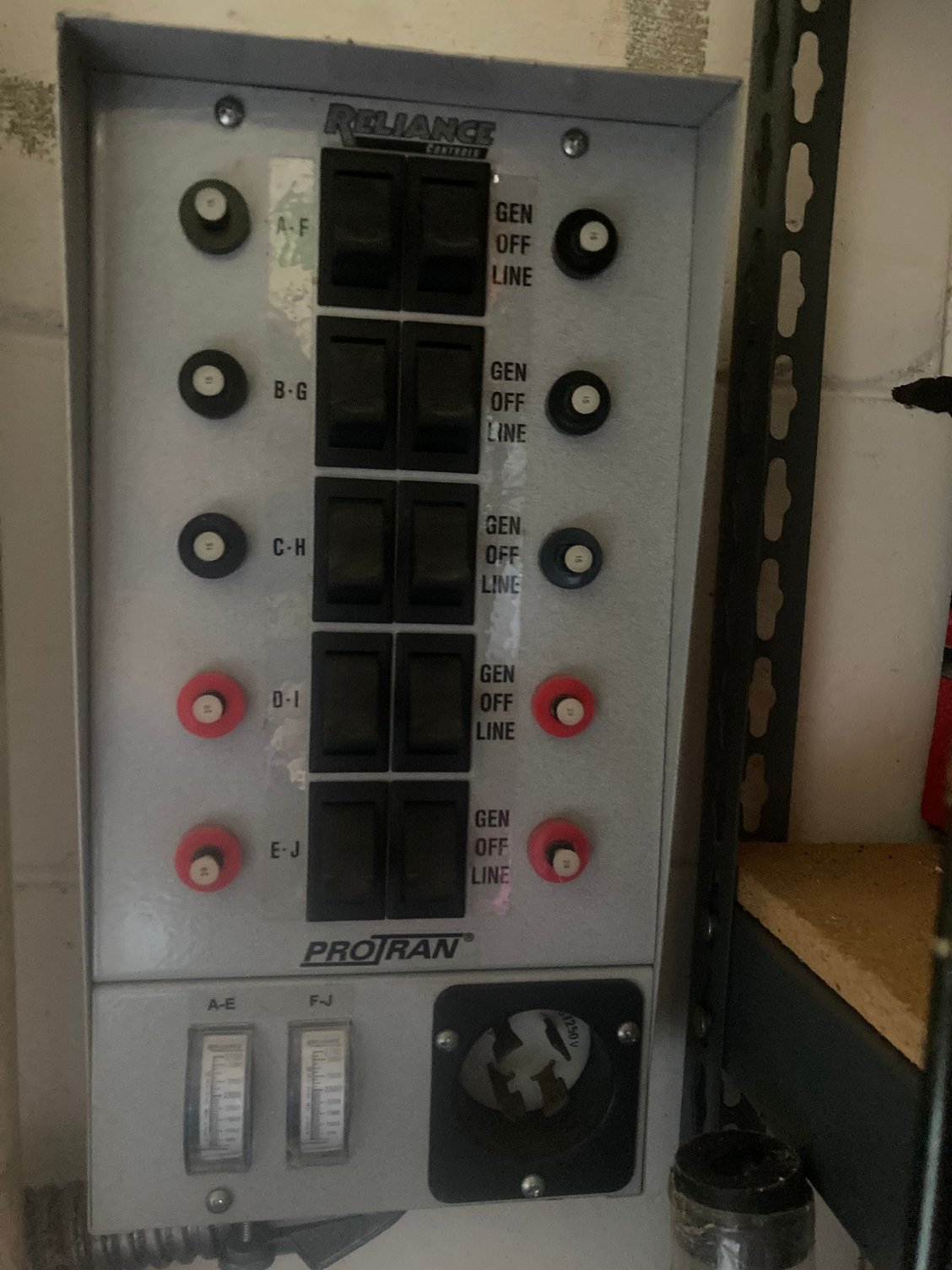

Posts: 960
Below is a 15-year old manual transfer switch that I use with a 7550 generac generator for my house when needed.
I have used it after we have lost power from hurricanes over the years and it will do most of my house ( except for the AC). I have never worried or knew about GFIC when using these two together. And they always worked fine. Will I be able to use the 7.2 gennie from the F150 Hybrid w/o any mods in the same manner?
