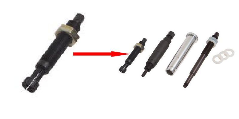

I'm looking for the porcelain puller tool now. So far the only one I've found is the one that comes with the Matco Tools, 3 VALVE TRITON BROKEN SPARK PLUG SET. (Part No. BPR4) $159.00
And there's no way I'm going to pay that for a tool that will use one time, then never again.
I can get the kit as a loaner tool but it doesn't include the Porcelain Puller.
Anyone got any leads to where I could get the
Porcelain Puller?
I got the plugs from Amazon for $62.00 (set of 8) and they are legit.

I ended up buying the plug extractor kit from amazon. I paid about $94.00 for it, but I needed it.
I knew that I can't bend my back, or move my neck much, and the brilliant idea the to lay this plank across the engine bay. So, I built the plank.
Then I padded it with a thick blanket and used a rolled-up pillow to support my neck as I lay on my side.
It worked like a champ. Once I got in the right position, I didn't know if I wanted to work on the truck or take a nap, it was so comfortable.
But I did manage to get three of the sparkplugs out that weren't firing, and that was a 90% improvement.
Then It turned cold and my body refused to move. Then I caught Covid... I got over it pretty well. A lot better than I would have thought, with all my underlying health problems.
So, anyway, here I am and I plan on working some more to change the rest of the plugs, as it warms up and before it gets too hot.
I have an overheating issue which I'll post about on another thread.
I watched several Youtube videos on using this plug extractor kit, and man it works perfectly as advertised. I greased up the threads of the porcelain puller threads each time I used it.
And it is still sharp. I hope I can get the other 5 plugs out without needing to order another one.
