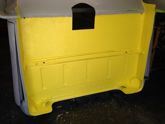

mine was missing so I fabbed one from 1.5" square tube and added the arch...bolted it in and covered with MonstaLiner...
