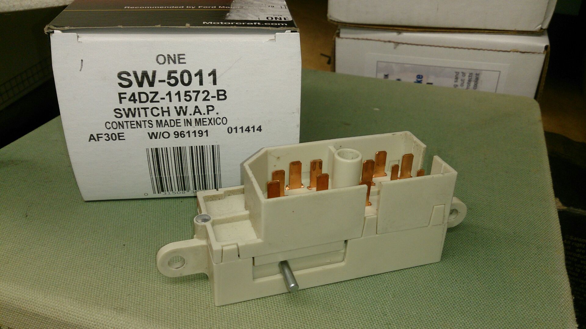

Sound from left side of dash could be the fuel pump. It's mounted to frame below drivers door.
Whatever electro-meld that happened with the engine swap needs to be looked at.
In my limited experience of a similar dash powering on/off the culprit was the ignition switch mounted to the steering column.
