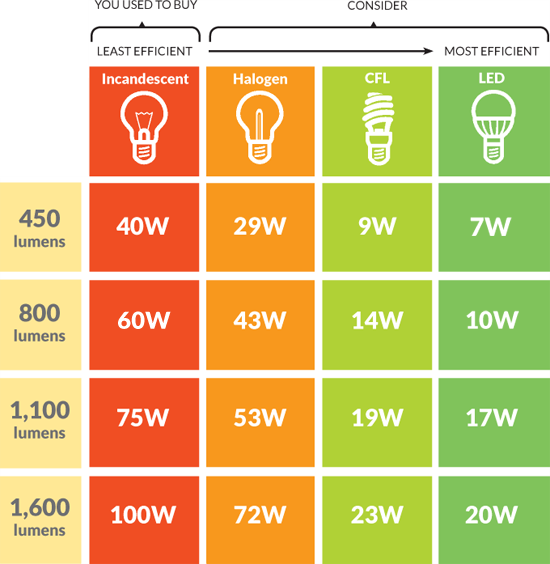

Now that is a valid question.
Using power consumption (Watts) to measure light output is ONLY a valid yardstick of light output if the electric-powered light sources being compared are IDENTICAL, meaning the of the same type (design), filament material, filled with same inert gas at the same pressure and volume (if applicable) and have the EXACT same housing/reflector.
By the logic you are applying, a 40-watt incandescent bulb will emit more light (since it uses more watts) than a 10W LED or a 25W CFL. Which it does not, not by a long shot. The 10W LED and 25W CFL both have much higher luminous efficacy than the 40W incandescent and are 100W incandescent equivalents in terms of light output.
So let's look at what you were trying to do. You are trying to compare an incandescent sealed beam that is in a moulded housing designed to achieve a balance between reflectivity and strength to a Halogen lamp that has higher luminous efficacy in a housing that is only designed to optimize reflectivity.
Do you understand the futility and the absolute stupidity and ridiculousness of using power consumption (watts) as a measurement of the potential light output between different types of lighting devices in different styles of housings? It is as ridiculous as using power consumption as the yardstick for comparing light output between an incandescent lamp and an LED or CFL. And CFL's can really mess this up as their luminous efficacy is dependent on ballast design and phosphor coating. Two CFL's of the same wattage may have huge differences in the emitted lumens (brightness).
SO does it take more wattage to make to more or emit more light?.... NO it does not. (This especially true when reflectors are thrown into the mix.)
AND wattage has NO impact on light output UNLESS you are comparing IDENTICAL types/styles of lighting devices.
So trying to use Watts when comparing 2 different types of electrical lighting devices is absolutely futile. This is why we have light measurements like Lumens, Lux, and Candle Power and Foot-Candles to make those comparisons with.
And you had NO clue WTF you were talking about and still tried to argue the point and now you got all butthurt. Well least the Daves got that in common.
And likely you have no idea where the voltage drop occurs, since you did all the measuring do tell where is it... or is this going to be like you with the watts as a light comparison (no clue)
And new vehicles control the headlights through the lighting/body module via the can bus.
And when you grow up you may realize that just cause someone sells it does mean it is a good idea or safe, not as if that has ever happened before. And there is always some future darwin recipient dumb enough to be duped into buying it.

Oh brother.
Here try reading this again.
" You are trying to compare anincandescent sealed beam that is in a moulded housing designed to achieve a balance between reflectivity and strength to a Halogen lamp that has higher luminous efficacy in a housing that is only designed to optimize reflectivity."
Maybe this can help ya let go of stupid.
(Dated since LED efficiency has improved greatly since this was published)
