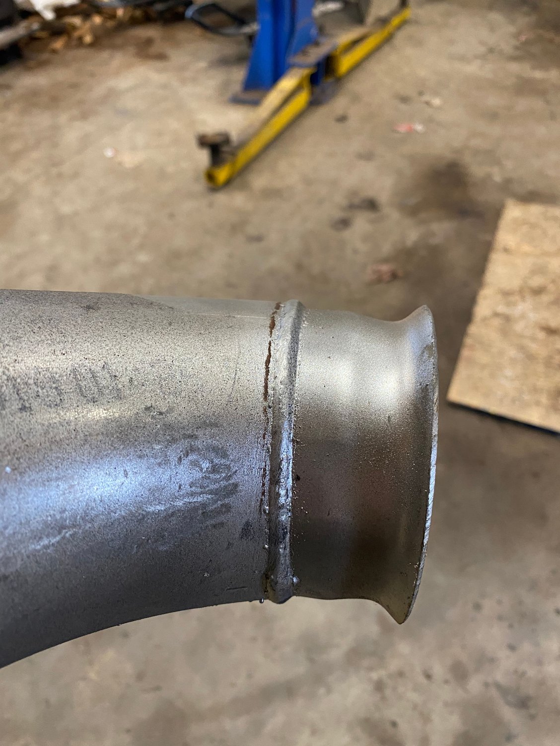

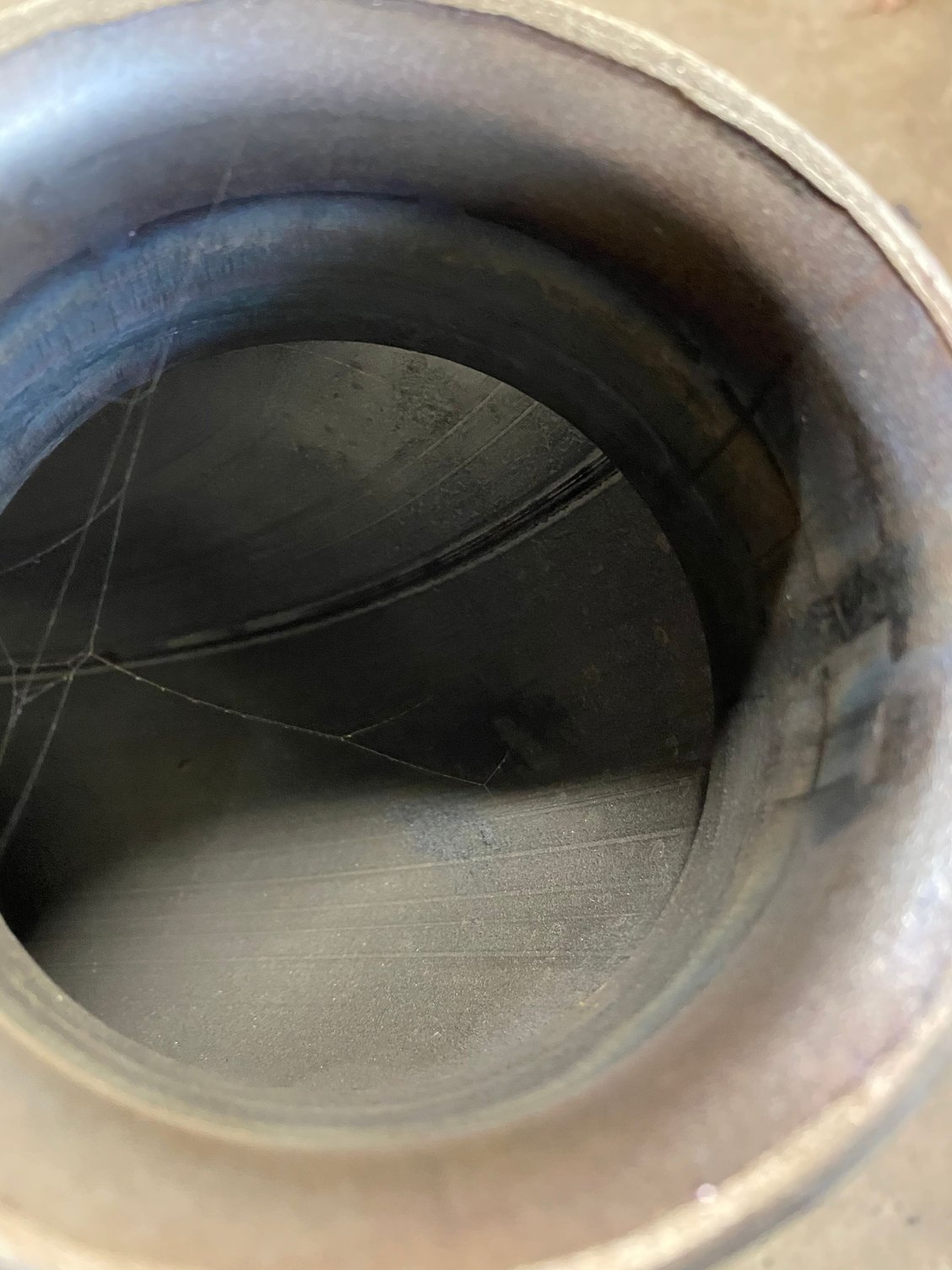

Couple pictures of diamond eye 4” down pipe.
The collar is slip fit and welded into the down pipe, essentially 4” is bigger then the turbos outlet and choked down slightly to ~3.5”
Picture looking into the pipe. Not sure what gains would be had with a 4” down pipe on slightly modified vehicle but my money is on none.
