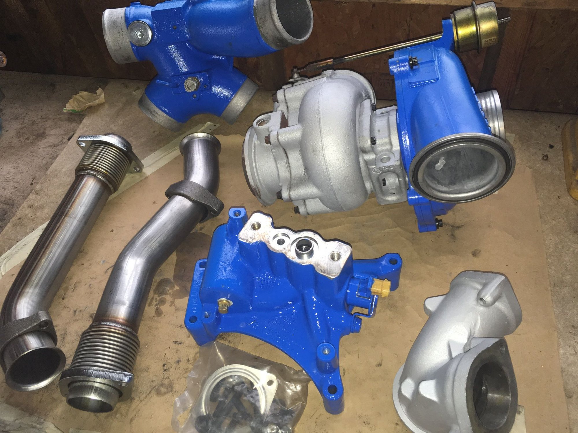

First, up-pipes are not significantly easier with transmission out. You still need to remove turbo...
I never replace the v-band clamps.
Are your exhaust manifolds leaking?? They almost certainly will if you install exhaust manifold gaskets.
Check out the write-up for how I do up-pipes and turbo mods if you haven’t yet.
https://www.ford-trucks.com/forums/1...lete-pics.html
If that is a Ford transmission, shouldn’t it be under warranty???
Old Mar 25, 2021 | 07:23 AM
SkySkiJason's Avatar
SkySkiJason
Joined: Jul 2008
Posts: 12,782
Likes: 2,142
From: N.GA Mountains
I would recommend plenum inserts, t-bolt clamps to replace worm clamps and upgraded CAC boots.
Also, remove clamps from fuel lines in valley.
You may consider upgrading compressor wheel while turbo is out.
And paint. VHT flameproof (2000*) on carbon steel hot parts. I use rustoleum 2x coverage stuff on everything else. Surface prep is the key to success. Clean (100% grease and oil free) is mandatory. Do not use a wire wheel - this spreads surface contamination and leaves a smooth surface that is harder for paint to bond to.
